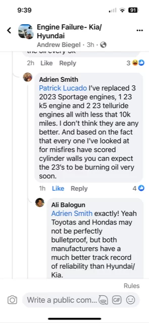

Because the group is entitled Engine Failure- Kia/Hyundai and there is a new pile of people joining it every day to try and figure out how to get their engines replaced by convincing K/H to honor their warranties. The problems are a combination of machining chips left in the engines and blocking oil flow, and/or carbon build up that chunks off and damages rings and blocks oil passages. The usual failure from either is a connecting rod coming through the block. K/H are replacing so many engines that some have waited more than a year to get theirs done. The group is mainly customers with these broken cars, along with a few mechanics and others trying to help them.The biggest issue they seem to face is that K/H does every thing they can to blame the problem on the customer and avoid paying for the replacement. The cars affected are most of their models from 2011-2023. Here's a sample reply from a mechanic at 1 shop, many people hope K/H have fixed the problems after all these years, but they clearly have not. Despite avoiding as many warranty replacements as they can, every K/H dealer seems to have one or more techs who do nothing but engine replacements.
If you'd like more samples from the group let me know.

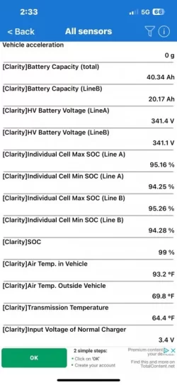

Hello all I have a 2018 Clarity plug-in hybrid regular model original owner bought in Dec 2017 now 83, 608 miles used primarily all EV miles charged at level 2 - Batt Cap at only 40.34. I commute about 25 miles each day at work and have a level 2 charger at work as well as at home. I was trying to enter my data in the Google spreadsheet but it would not allow me to or I am doing something wrong lol! Thank you
**Update I was able to enter data on the spreadsheet thank you**

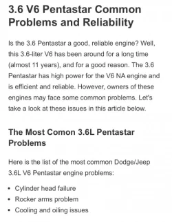

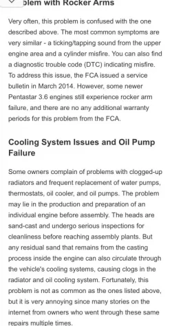

Digressing back to the ICE engine failure rate as compared to EV battery failure rate, the following screenshots were taken from a 2022 article that covers the most common problems with the Pentastar 3.6l V6.
Cylinder head failure was the most common problem and those represented 0.5% of all the engines produced from 2011-2013. A revised design virtually eliminated the problem. Another article discussed the failure of one of the engines at 626,000 miles. The failure was due to timing chain guides and tensioners.

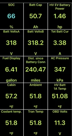

Received my Vgate iCar Pro BLE 4.0 as a Christmas gift, and installed it today. Since I'm new to this, I don't quite understand all the readings I received for my 2018 Clarity Touring with 31,600 miles (garaged). My battery capacity is 50.7 Ah. I'll attach a photo of the readouts I received. Thanks for all of your help figuring out which unit to buy, how to install, and how to evaluate readouts.
Dan:
Welcome to the Clarity Battery Capacity Club !
To put your reading in perspective, you can go to THIS LINK
My eyeball says that an average capacity for ~30K miles is around 50 Ah so you are doing just fine.
