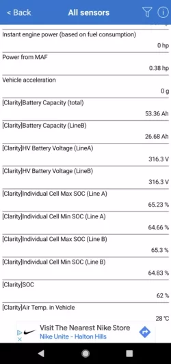

On Nov 2022 I reported my battery capacity was at 44.6Ah. I decided to do a check this evening and found out it was at a whooping 53.36Ah! I have a 2018 with 71500 miles on it. I attached a screenshot of the readings here for everyone's reference. Am I reading it wrong? Is temperature the contribution to this discrepancy?
Any insight will be much appreciated.

You have been afflicted with the mysterious battery capacity 'reset'...
Read the section entitled "Odd 'Resets' of Battery Capacity" at the bottom of this page:
https://github.com/clarity-phev/Battery-Capacity-Read
During the interim between November and now, did your 12V battery die? Did you have the car at the dealer for service where they may have disconnected the 12V battery for an extended period? We have not conclusively identified the cause of this, but I feel that the dealer can reset the capacity (either intentionally or unintentionally), Or, an 'extended' disconnect can likely cause it.
Your capacity will slowly return to 'normal'. It may take months depending on your charging pattern. This is one reason that I recommend reading the capacity 'regularly'. I do it once a month, but that is overkill. Every few months if probably good.

My car was with the dealership 3 weeks ago for replacing the AC condenser so that is likely why. But I never lost any of my radio settings so I do not know if they actually disconnected the 12V. It is truly a blizzard phenomenon even the kwh that the car is able to hold is higher now.
