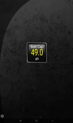

Here is a view of the custom PID setup, and the Battery Capacity being displayed in Torque :

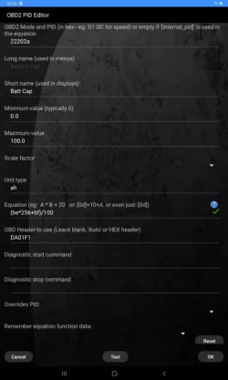

Well I have Torque Pro Plus; and BAFX reader and I added the PID; but get "ECU does not appear to support Mode $06"
when I do a scan... I did have to enter a 'long name' to have the new pid accepted. Scan didn't work; but a lot of the rest did

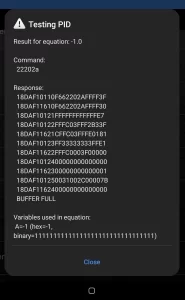

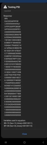

While you are in the PID editor mode, there is a "Test" button at the bottom. What do you get when you hit that?
One other thing that I did was turn off headers. I did that with an entry in the vehicle profile under "Very Advanced - ELM custom configuration string..." by entering ATH0 there. Show us what appears in your Test mode after doing this...
You can tell immediately while still in the PID editor if it is working with this Test function. It is a lot easier than going back to the dashboard and trying to hunt down a PID among all the others. This presumes a live connection while working on the PID.
You want to see something like this in "Test" mode:
If you see this, then your ELM isn't cutting it:
Note: The Header is off in the 1st picture, and on in the second, but it illustrates the point about the BUFFER FULL from a "Bad" ELM...

Well that is/was very frustrating... tests ok, ecu connected still has the ecu does not appear to support mode $06
so if do vehicle test results it goes up and then error msg and then it refreshes continuously
the only place to find the battery is in the graphs and it says -2.57 ah and I certainly don't see a nice Batt Cap anywhere :-( from the image
I have (be*256+bf)/100 possible a wrong char? thanks again

sorry - missed your images above... yes I get 'buffer full' so I guess I am beat with this.. will just wait for the autel
Yes. You are screwed with your BAFX device... It will not work.

Since you have buffer overflow, your ELM isn't going to cut it, but just an FYI, the PIDs are all mode 22, so the error message is incorrect

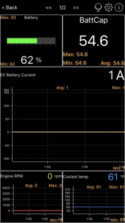

Car Scanner is a cross platform iOS/Android alternative that works better than Torque Pro. I just discovered it today. Torque Pro has a bug, in the way it handles the large messages that the Clarity outputs, and wraps the data. So it can't extract all of the the other info out of the PID that we're using to get the battery capacity.
https://www.carscanner.info/
Another thing that's nice is that even the free version works to get the battery capacity.

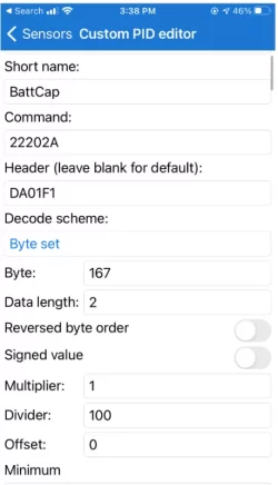

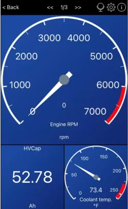

Here is a screen shot of it displaying the battery capacity:
Here's how to input the PID into Car Scanner:
BTW, though we haven't tried them, if you have an OBDLink SX/MX/MX+ they should all work, since they're based on the STN1110 chip, which is more powerful than even a real ELM327 chip.
Everyone who gets this working, pls post or private message me with your actual values, so that we can verify that we decoded the data properly.

Mine is reading 54.6 Ah. This is a 2019 model (bought July 2019), with about 12500 miles. I saw about 50 miles actually driven during a recent battery full charge with temperatures around 50F and no AC & heater.
I usually keep my battery levels between 40%-70% as my commute is pretty much fixed (11 miles one way, have access to EVSE at work and home).
