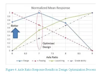

GM engineers published their design decisions in an SAE paper last year. They did an optimization process for axle ratio, which would affect the top vehicle speed available given the motor's red-line RPM. 6:1 would have given highest top-end speed. 9:1 would have been Tesla-like launch speed. The went 7.05:1 to optimize range, with very good passing acceleration and acceptable launch acceleration and grade climbing. See graph below from the paper.

Great chart! Thanks for publishing it.
