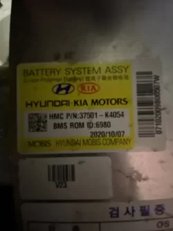

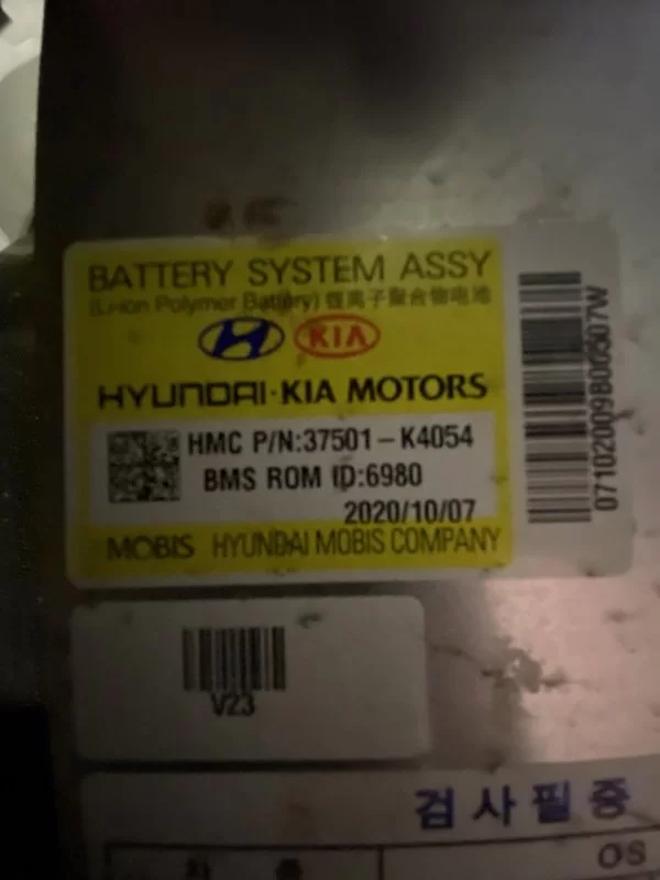

Thanks...just checking your battery manufacture date . The date of 2020/06/17 on your old pack is past the recall car manufacture date of March/2020 which is not really the news I was anticipating. The BMS ROM ID is identical to mine as is the Part#37501-K4054.
The only difference between mine and your old one is the manufacture date - mine being 2020/8/27, ~2 months later production than yours. Not sure how long they stock the individual cells before assembly into module/pack format, but I am hoping they may used some cells possibly manufactured before March/20 in your old pack, and the cells in mine are assembled with later manufactured ones (hopefully without defects as but I guess only time will tell. It is nice to keep track of these things, just to provide a little more clarity for the answer to the chicken or egg scenario; was it a manufacturing defect that was found and corrected or BMS issues (overcharging/overvoltage/cell leakage thru insulation separators etc).
Thanks for the update. BTW - what is the label on your new one?
EDIT- you must have changed your previous post, sorry to hear about the bolts, that would drive me nuts:eek::D
Hopefully they get the new ones in quick.
Here is the label from my new battery.
Same part# and BMS ROM ID as mine. Manufacture date on mine is 2020/8/27 so your is ~5 weeks younger. Hopefully these ones last a lot longer than your previous one manufactured 2020/06/17 and it was a one off after the recall close date of March 13/2020- note the BMS ROM ID and part # are the same in your original.
BTW congratulations on finally getting your car back:)
