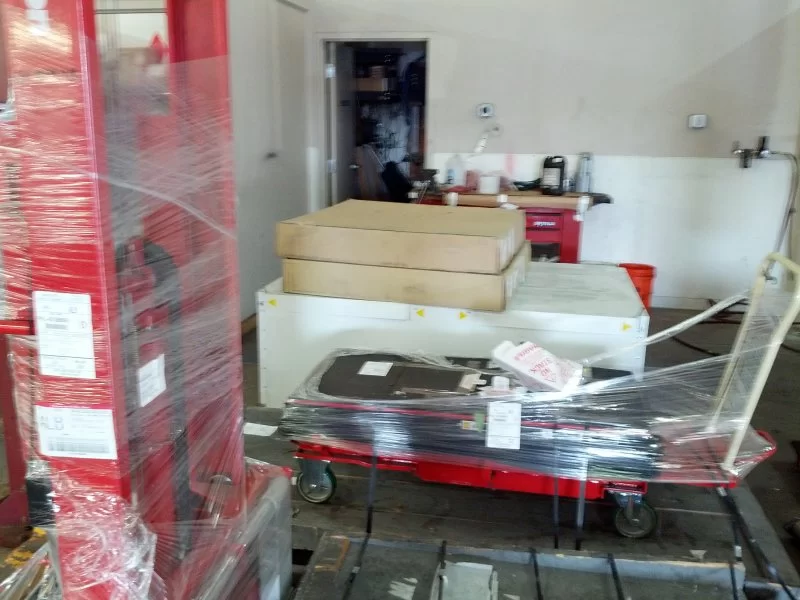

Finally I got news. The replacement HV battery is at the dealer, so is one of the two tools needed to replace the battery, the hydraulic jack is at customs. Still waiting for the second tool.

Yesterday my car had her 3 month anniversary of sitting in the dealer's lot. I was told last Friday that they, got the battery and one of two tools, and the hydraulic jack was released by customs. The second tool was also shipped.
