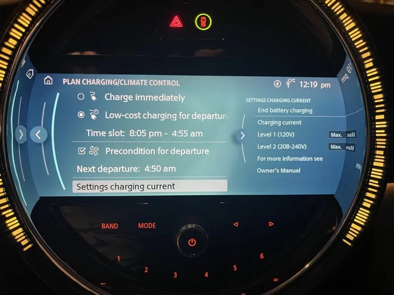

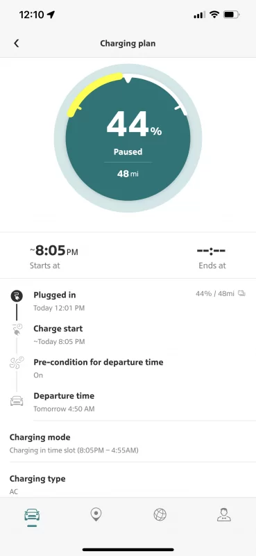

OK, to avoid any issue of maybe the EVSE timer fighting the car or whatever I made some changes for tonight:
I adjusted the cars charge start window to begin at 8:05pm and end at 4:55am with a departure time of 4:50am
I then disabled the EVSE's charge window so it's always on.
The car is already plugged in while I am doing this.
The EVSE very briefly showed "charging" when I disabled its window but then went back to "EV Connected".

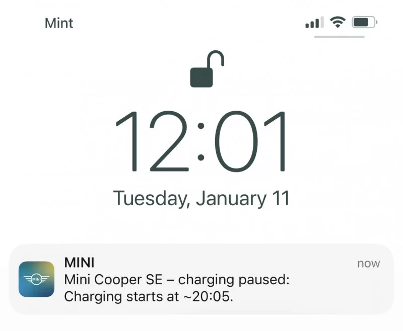

I then got a notification from the Mini app:
So it says charging is paused, which is good, but it also says it will start at 8:05pm which is when the charge window opens.
Based on what happened for you I would not expect it to start charging at that time as even though it currently sits at 44% it won't take long to get to 100.
Long before the departure time set...
This is really weird...
It says "plugged in" but what it means is the EVSE woke up at that time as it has its own 8:00pm to 5:00am window as I normally have the Mini set to charge immediately and just added a charge window to that for this experiment.

I set the charge window in the car also for this purpose.
So the EVSE is a wider charge window, and the one set in the car is within it.
However I have now disabled the EVSE wider window in case that in some way confuses things so we'll see what it does tonight.

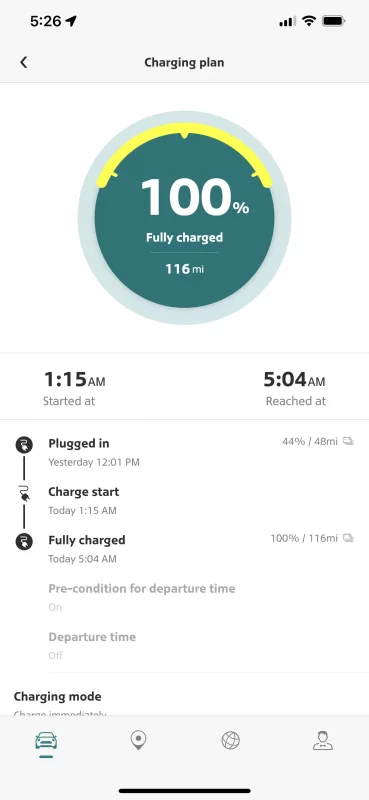

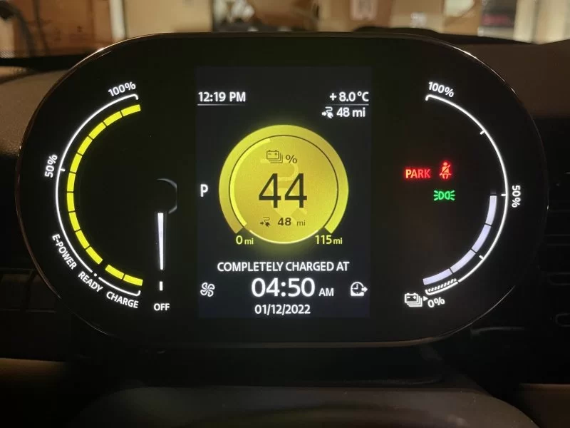

The car seems to think it will finish by X time (no idea what it said yesterday as I set everything by the app so didn't see the car):
In my experience, the app always advertises that it will begin charging at the start of the time slot and the car always advertises that it will be completely charged by the departure time--regardless of the car's state of charge and how much charging time is actually needed. In practice, the car begins charging well after the start of the time slot and invariably reaches 100% a few minutes before the set departure time (even though the app will often report it will be done by a few minutes after the departure time once it actually starts charging).

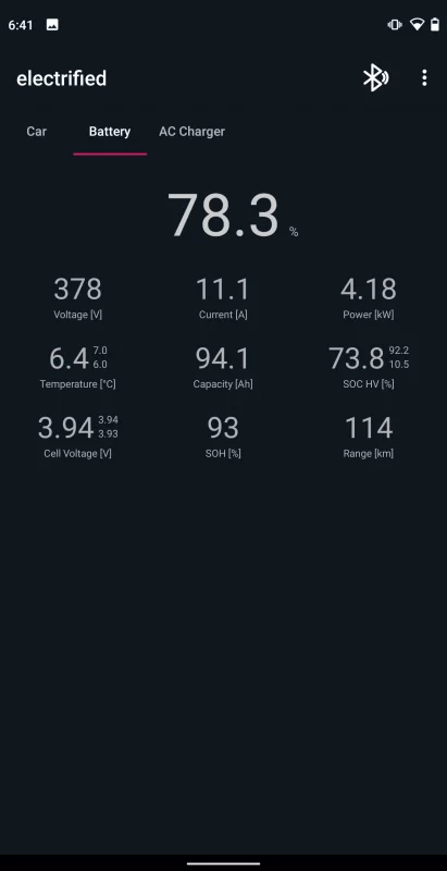

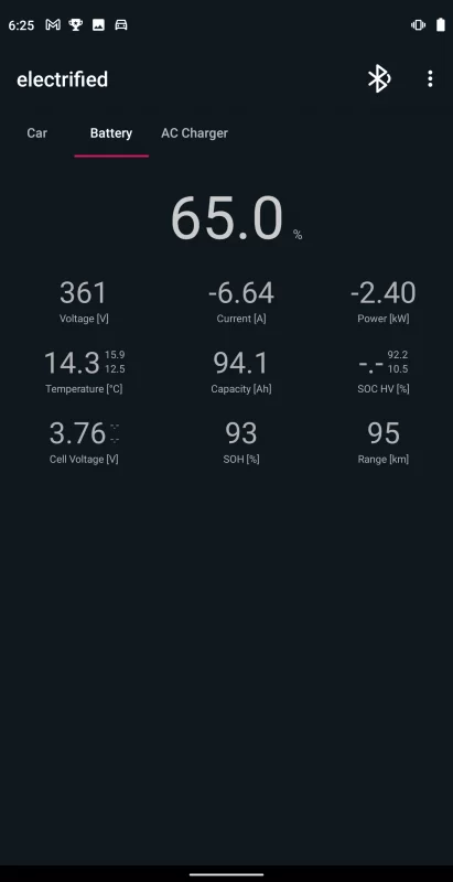

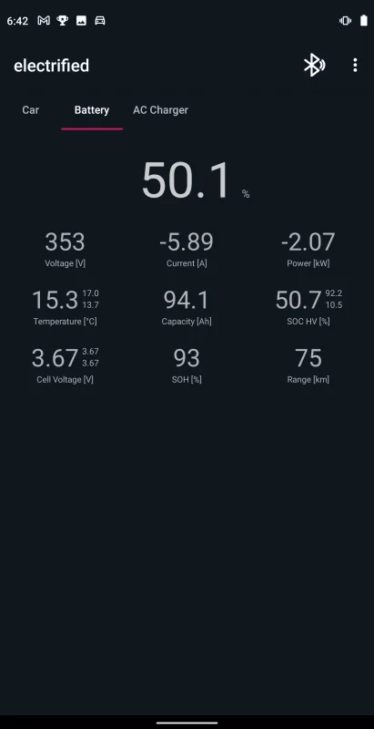

So - I took some battery temp measurements last night and this morning on my i3 for reference. I know it's not a Cooper SE, but maybe you guys would find it informational/useful since they share the same powertrain/battery.

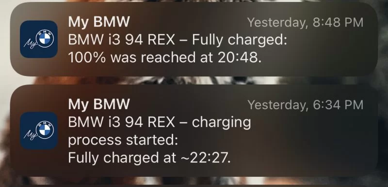

This is from my 2018 BMW i3 REX (33kWh battery). My partner drove it to work yesterday (short, 15mile commute). I went out and plugged it in around 5:45PM at 77% SoC (charging was delayed because I didn't realize I had accidentally locked the charger, otherwise I have the car set to start charging immediately). After I found my bluetooth ODB adapter (VEEPEAK brand) and an my old Android phone with the "electrified" app, I measured the battery temp at 6.4C. SoC had risen to 78.3% per the app and outside temp was registered as -2.5C (this is from the app, I'm guessing it pulls from the cars registered outside temps since actual outside temps were 20-23F, -6 to -5C).

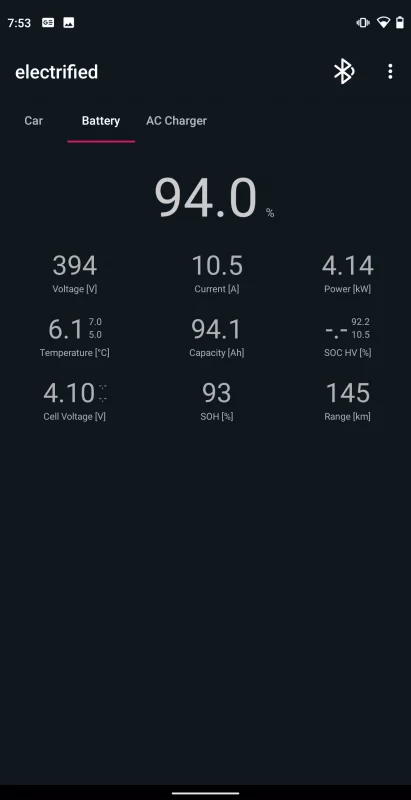

Went back out at 7:53PM to check on things and battery temp was now 6.1C, 94% SoC, and outside temps registered -2.0C (actual outside temps are -5 to -6C).

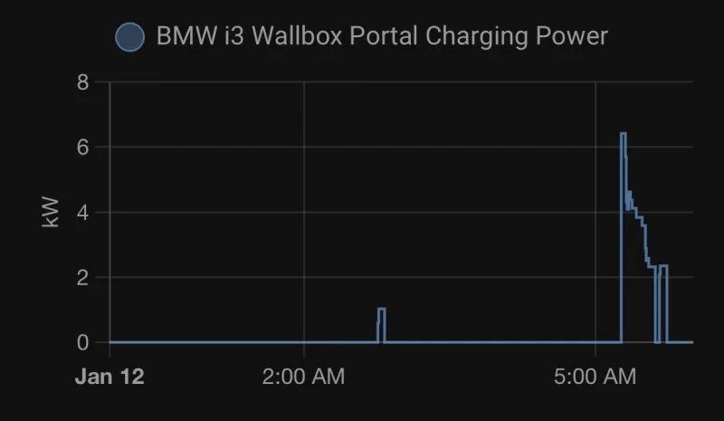

I had a departure time set for 5:45AM via the BMW App, with pre-conditioning on. The i3 had finished charging to 100% at 8:48PM. Temps last night hovered around -6C to -5C.
I went to leave the house around 5:45AM. The i3 had pre-conditioned and the cabin was nice and toasty, as usual. I saw the same power draw info from my EVSE as I usually have. A short small draw around 2:45AM and then normal pre-condition started around 5:15AM with a max draw around 6.42kW at the start, it was still pulling from the EVSE when I left around 5:45AM.
After a few minutes of trying to get my phone reconnected to the ODB dongle it was now 5:49AM. The battery temp was 10.6C, 100% SoC, and outside temp measured -4.0C. This shows me that even at 100% SoC the i3 is indeed doing some battery pre-conditioning. Maybe not warming it up as much as it should (or that would be most beneficial), but it's better than nothing.
For some additional data - about 33miles into my 46 miles commute to work I registered a battery temp of 14.3C, 65% SoC, and outside temp of -6.5C.
I drove in "Comfort" mode (Mid mode on the Cooper SE), with climate set to 66F. It was a 51min/56mile commute with an average speed of 55.7mph (this is from my trip meter so probably more like 58-60mph average, it's almost all highway with cruise at 67 and a small bit of 76). I arrived at work with 50.1% SoC and a battery temp of 15.3C.
I'm very curious to know if Cooper SE owners would see the same results. I'd assumed they would since the i3 and SE are fairly similar. Hopefully this helps some of you with additional information/data.
@methorian Thanks for posting that data, my next task was to get the battery temperatures so this was very useful.
I can also confirm that our car delayed charging to finish before my departure time.
I suspect it didn't happen the previous night as the car was already plugged in so was "in session" when I made the schedule (even though it was 12 hours before departure time) or because the EVSE charging window was too close to either side of the cars charging window. But it is working now:
The charging window configured in the car was for 8:05pm to 4:55am btw.
Departure time was set as 4:50am
It actually finished nearly 15 minutes later than the departure time and I don't know how much heat was in the battery at that time much less at departure time.
However I suspect that is because the effective charging rate slowed down as the car was pre-heating the cabin for maybe 30 mins before departure so was doing that thing where it hovers at 99% while pre-conditioning until I unplug it. So it is actually at 100%.
I did not actual use the car and I noticed that it was not drawing anything from the wall when I checked at 5:26am so I guess at some time after the departure time when I did not leave it cut off the cabin climate. Maybe 30 mins? Total guess though.
