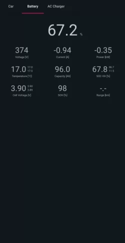

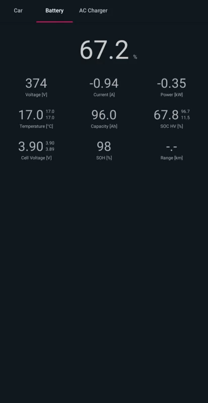

The electrified app (Android) does show state of health (SOH) but no idea how accurate it is since the app was developed for the i3.
Back in November mine showed 98% after 4 months... Extrapolating that would be 80% capacity after 4 years which is almost certainly wrong so either it doesn't start at 100 or is not anywhere close to linear.
Also, I'm just noticing that it says the percentage range for the HV battery is 11.5 to 96.7 which doesn't match the previously reported buffer of 11.3%.
