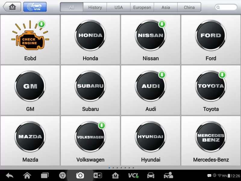

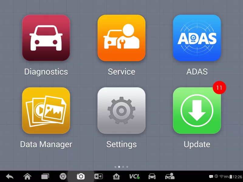

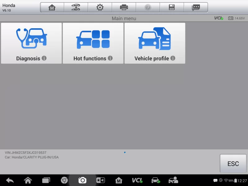

OK, let's see if this translates:
First, plug in the VCI to your OBDII port. You'll hear a beep, indicating the unit is getting power from your OBDII port
select the Diagnostic Screen
Which Brings you to this screen. You should hear a second beep from the VCI, which indicates the unit has established a connection with the module you hooked up to the car.

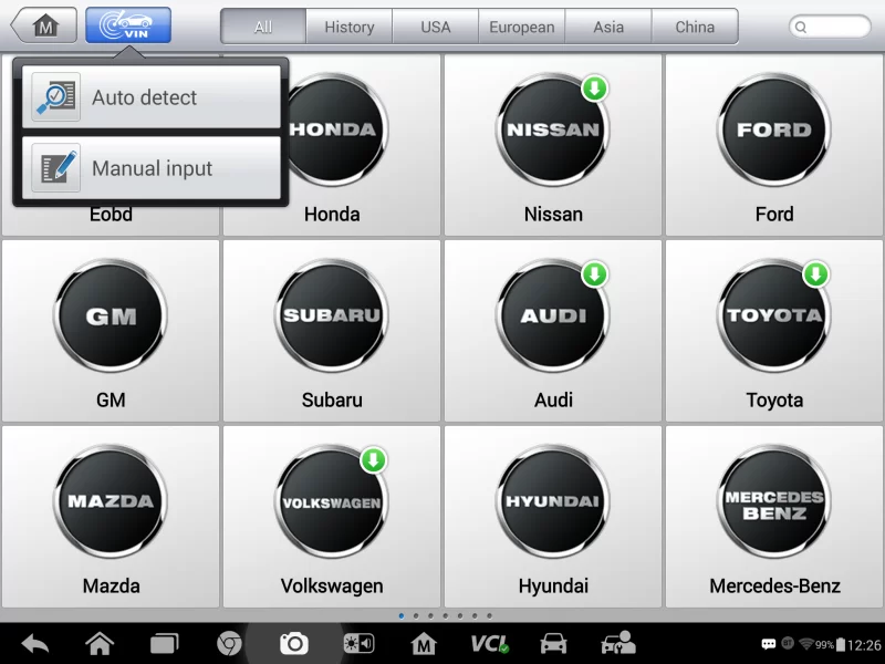

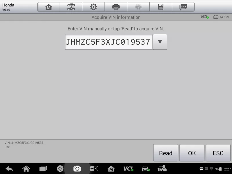

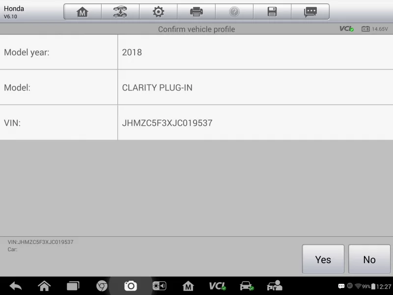

Select "VIN" at the top, then "Auto detect" once VCI icon has the green checkmark (see bottom of taskbar)

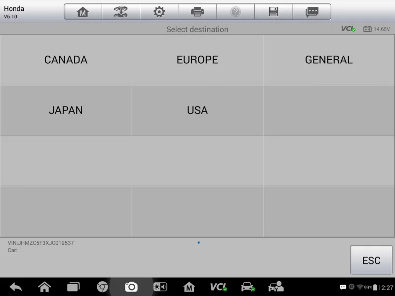

Hit OK
USA (Market Region)
Overview (tap Yes)

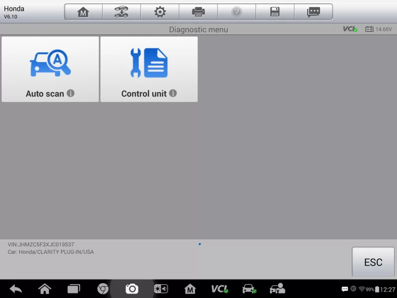

Diagnosis

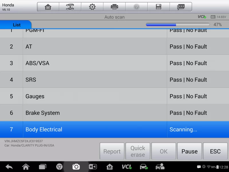

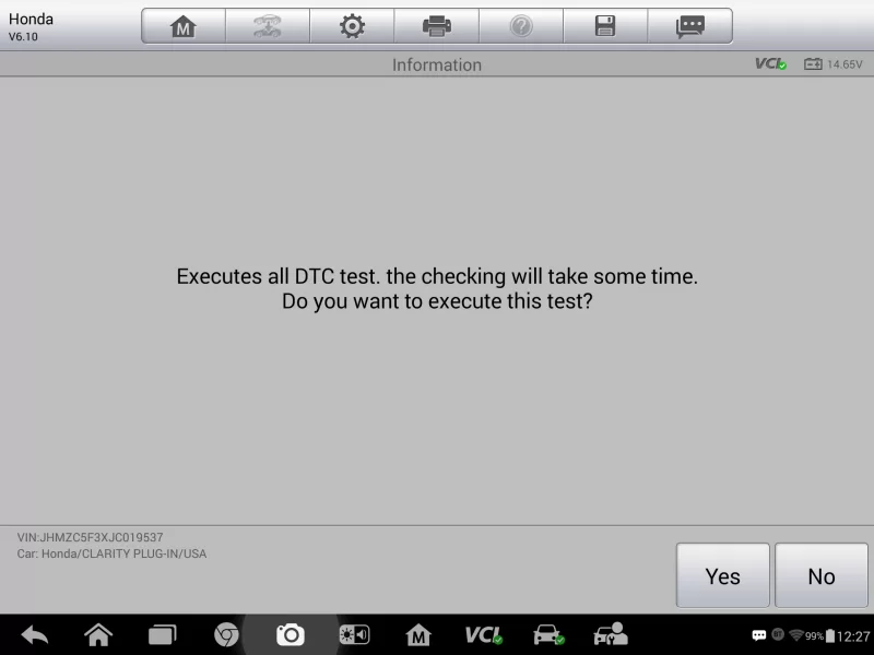

Auto Scan
Tap Yes, then OK in following menu

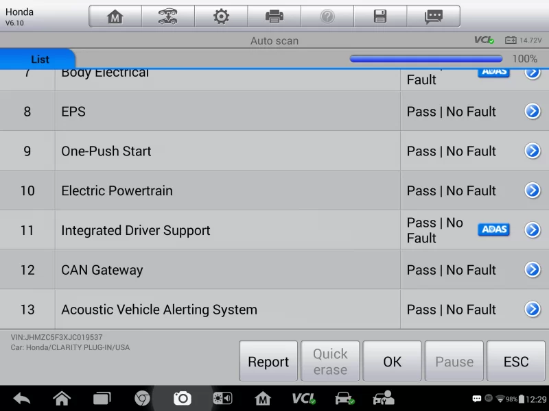

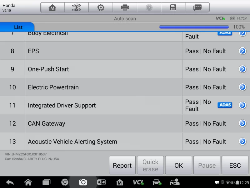

Will look something like this, and scan takes ~4min to complete

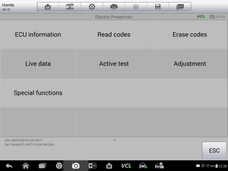

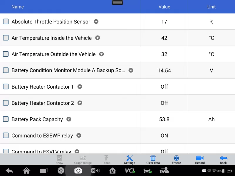

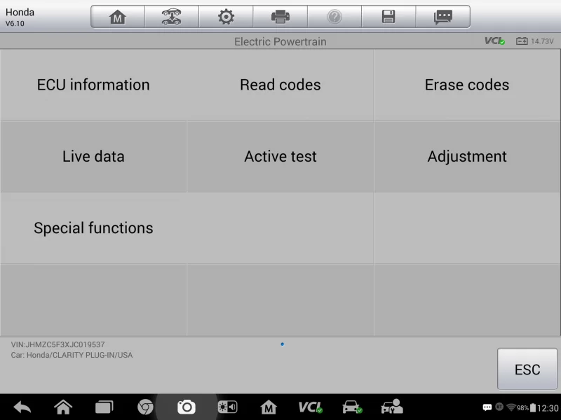

Once complete, tap blue arrow next to "Electric Powertrain"
Live Data

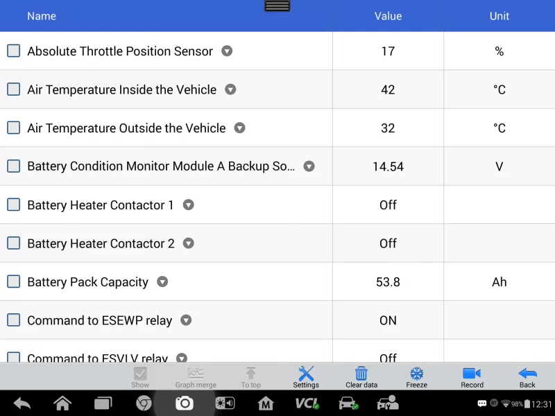

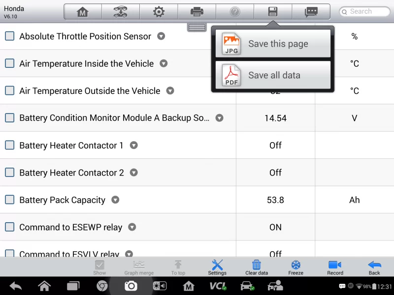

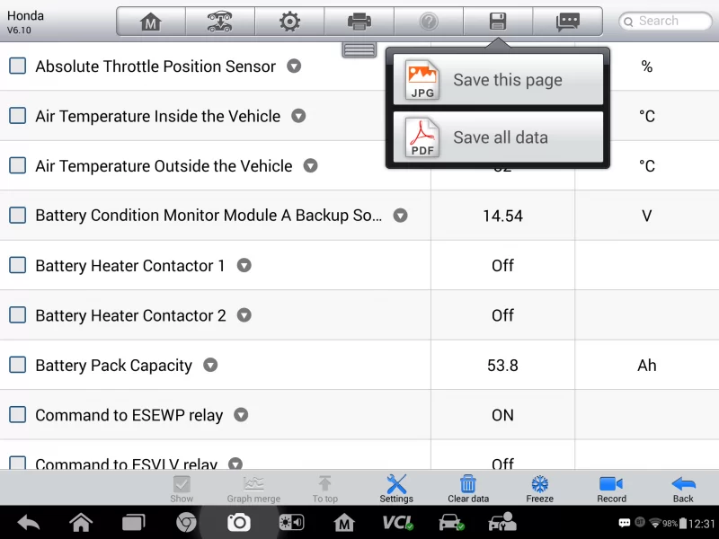

You are then presented with this screen, which captures the data you guys want:

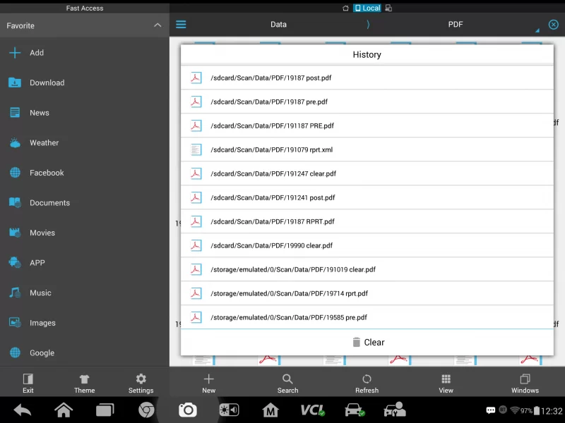

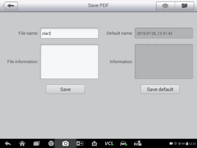

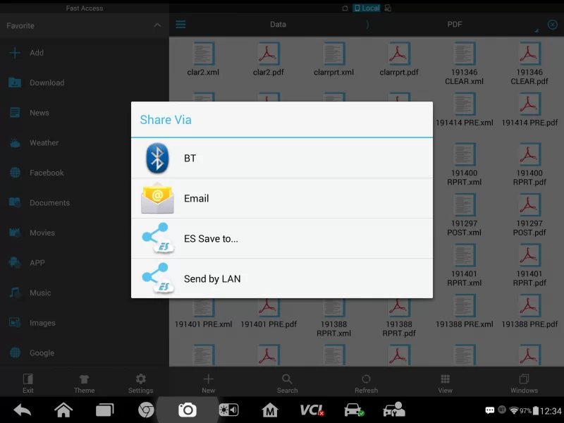

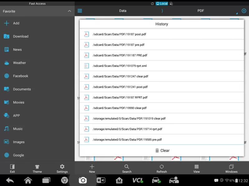

Pull down the top drawer icon, tap on the save disk, and "Save All Data" as PDF
Write down name of file, then save

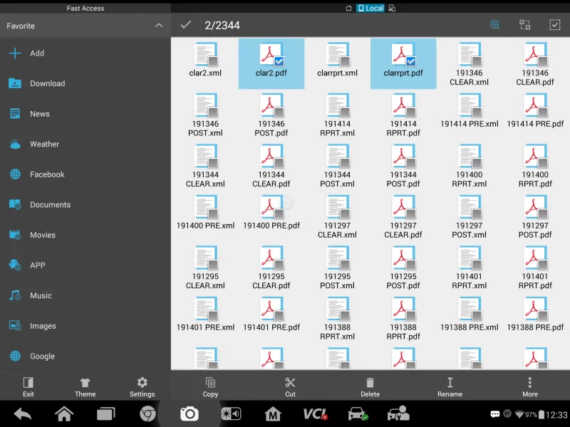

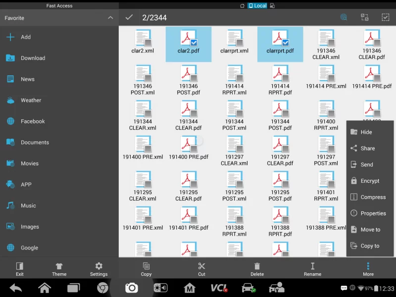

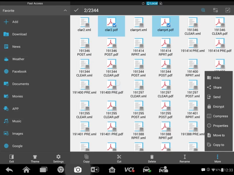

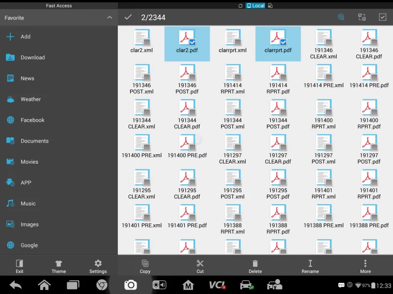

Which gets deposited into the Scan/Data/PDF directory (which you can navigate through the file explorer found on the home screen)
Find files you want to upload, tap and hold to highlight the files you want

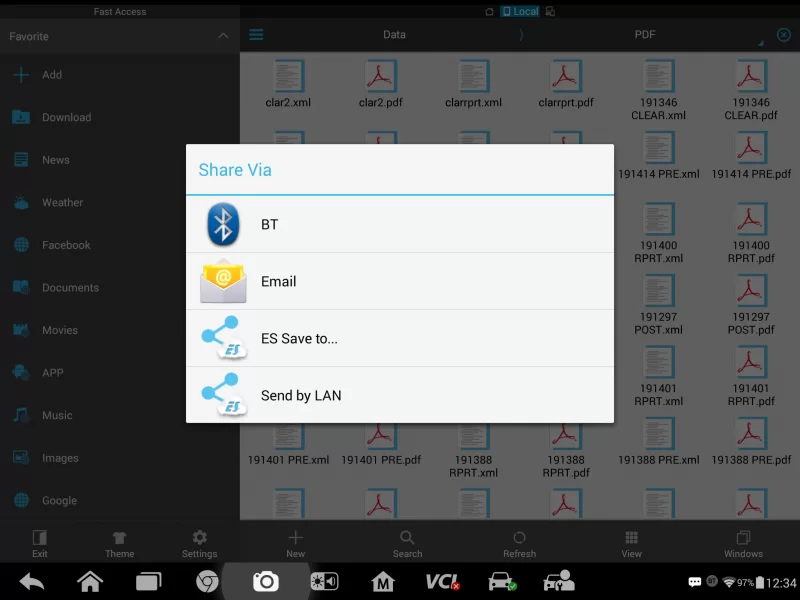

Select "More", then "Share"
E-mail..
Which brings you to the compose e-mail menu. Send it to your address of choosing and enjoy the dump :)

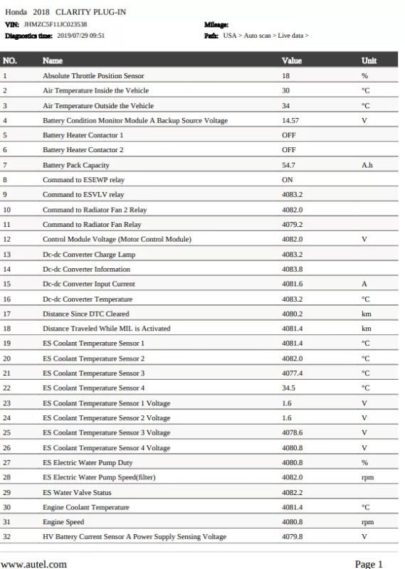

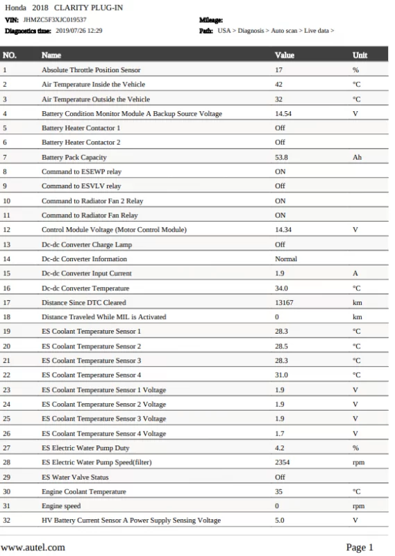

I wanted to point out that something looks odd with your output data. If you compare it carefully to the earlier example that @AlAl posted (his 'clar2.pdf vs. your 'elec.pdf') you will find numerous entries that seem to be improperly scaled / decoded on yours. To highlight what these 'problems' look like, here is page 1 from 'clar2.pdf':
Now here is the same page from yours...
You will notice that yours has MANY values that are not plausible (they are all of the form 40xx.x). The good printout demonstrates what these should look like.
If you glance through your printout, I believe pretty much any value that resembles this 40xx.x) is likely bogus. Most notable are all of the very detailed battery cell voltages later on pages 5-9.
Don't get me wrong... There is a LOT of good here. Perhaps there is a way to correct this issue. It sounded like you applied all of the 'updates' that you were aware of?
It would be nice if the printout reported revision information for the software or similar... Perhaps you can query software rev's and get a comparison from @AlAl 's good printout.

Good catch! I wasn't able to get back to it this afternoon, work called. I rushed to post the first pdf, but did not look at it carefully enough.
I was about to superficially note that AIAI's data was at two different SOC (79%, 83%), but it looks like my PDF is scrambled. I think (?) the cell voltages were all in the correct place on the live list on the tablet, but will check. My cell voltages were higher because I was at 100% soc, but I see your point, the pdf is all scrambled. Those look like cell voltages scattered in the wrong places.
I think I got it all updated (both the tablet and the OBD plug in). Could still be user error. Will try to look at again tomorrow, time allowing.
first question, are those values correct on the tablet screen display (first thing I will check). Maybe a call to Autel too if it's still scrambled on the PDF. Need to sort all this out during the Amazon 30 day return period!
I think your cell voltages are also gibberish... The numbers there are just too similar to the other ones that are definitely gibberish.
Also, Lithium Ion cells are just not that high (with the possible exception while they are being charged). If you were actually charging when you got this data, then try it again when you are definitely not charging. The cells will be more like 3.9-3.9 as shown in @AlAl 's data (regardless of SOC). I believe all the 40xx.x values will remain that way because they are not misplaced cell voltages, but rather improperly decoded values for other things.
