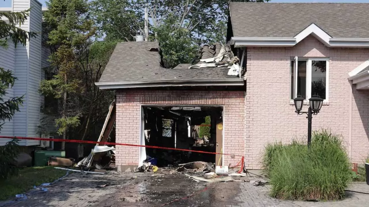

Took more than a year before any acknowledgement of possible defect, long after this first occurrence shortly after introduction into Canada:
https://insideevs.com/news/362202/hyundai-kona-electric-explodes-canada/
Hopefully it won't be a repeat down under:eek:
