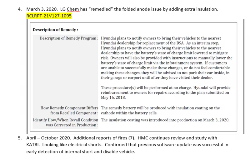

Same factory. The March 2020 date that everyone refers to is simply a date that Hyunday/LG recognized an issue with the anodes and added more insulation.
Recalls are designed for "safety reasons". Hyundai seems to have declared they "solved" the issue in March. Hence no more recalls after this date.
In april of 2020 Hyunday also added extra checks in the BMS system. Basically to disable the vehicle when an issue is discovered rather than start a fire. This disabled vehicle is not a recall issue, just a severe inconvience to the owner who has to wait for a battery. Problem solved!
