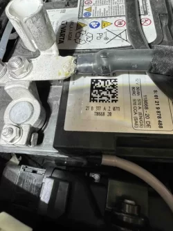

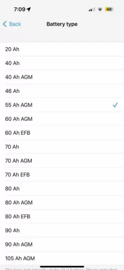

Having owned multiple MINIs and needing to replace a few batteries, my experience is they use AGM batteries and they have to be "paired" with the vehicle. I believe there are issues that can come up (errors, etc.) if one doesn't do the pairing process.
My now sold R56S' battery lasted 7 years and conked out about a year before I sold him. I have a BMW/MINI/RR scanner (looking forward to plugging it into a Rolls - wonder if the OBD port is behind a special panel or just under the dash like our pleb mobiles) and it didn't want to code it. The IBS is supposed to be on the negative cable and I didn't see one on mine so I guess I didn't have one. If you do have an IBS on your negative cable then yes do code it as if not done the battery can have a much reduced lifespan as discussed over at NAM.

I sold BMW I3 with 7 years old battery which was only 20 Ah as I was monitoring that battery for last few month was always 14.4 volts in a morning.SE 12V battery is 50 Ah compared to I3 is a monster size as both cars have the same equipment. 12 V battery is automatically charged through DC to DC system from HV battery if car is plug for charging or not as long the system operate correctly and 12 V battery is not a lemon I will not be worry about it as the oldest SE is about 5 years old I doubt if anybody replaced yet. I belive at dealer OM AGM - 12 V battery is about $450

The mini cooper SE uses a 50 Ah AGM Absorbed Glass Mat battery for its low-voltage system 12 v. For starting and powering accessories as HVB pack is a lithium-ion battery just to straight this opinion.
