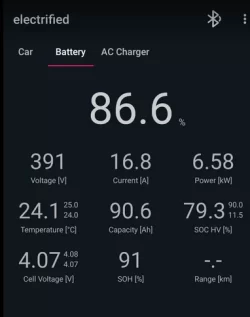

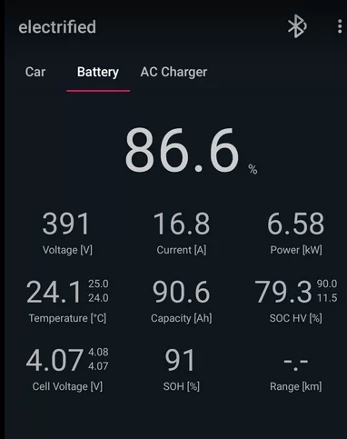

I've been taking a reading every month. This month's was not looking great
SOC 89.9 - 11.5. I'm guessing this represents the top & bottom buffers. The 11.5 stays pretty consistent, but the 89.9 is the lowest it has been. SOH & capacity just keep dropping, but if you take into account that the buffer keeps growing, the overall capacity seems to stay the same at about 113 to 114Ah.
I've only done DC charging once & tend to keep the charge in the 50-80% range most of the time. I allow it to go to 100% and sit for a couple hours once or twice a month to rebalance. 1.5 years on the road & 9k mi. I'll be interested to see what Mini has to say when I bring it in in June for 2yr maintenance.
I did do a 98mi drive yesterday & had 24% left over, so that is still well over the 114mi range rating
I’ve found that my SoH seems to drop during periods where I don’t leave the car plugged in and recovers afterwards, but it takes multiple days of being plugged in. If SoH is based on charge balance, I’m guessing your battery is out of balance enough that leaving it plugged in for a couple hours doesn’t do much.
Do you mean the mismatch between the nominal capacity and the capacity we’re seeing in electrified/mi3? I agree, it’s strange. I have 2 theories:
Yep. If I can pick one, I'll take option 2.

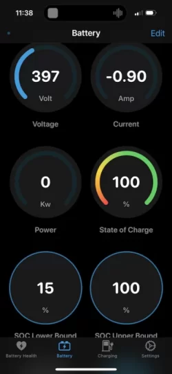

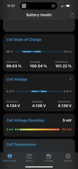

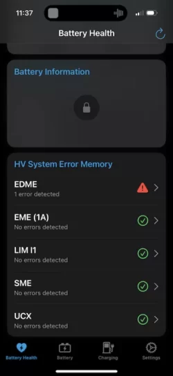

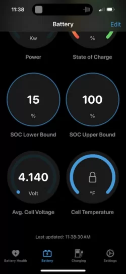

These screens are what you get with the free eFlow version, mini not plugged into charger. This is a 14,000 mile 3+ year old 2022 mini that is driven about 80 miles twice a week and charged overnight to 100%. On other days it may be driven a few miles around town but not charged until the day before these trips. You have to upgrade to see the EDME error as well as anything else. I don't see any errors reported by the Mini, dunno what the EDME error is. I'll have to look into it. Perhaps a way to get some money out of me :).

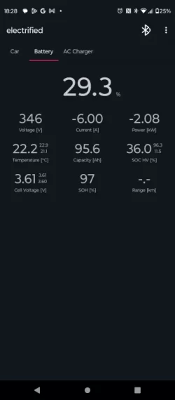

Just checked mine again. It had a 100% charge after the last check, and sat for a day on charge. Today, I ran it down to 51%, then fully charged again as I need a full battery for tomorrow. It's been floating a couple of hours. I've gained another 0.2Ah, now 95.8. Mileage now 30241.

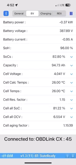

21,371 miles, 4 years old, 96% SOH:
Most charging is at home on Level 2. Not much driving the first year+ of ownership due to COVID restrictions, but I have taken several road trips the past 2 years with plenty of DCFC to get there and back (9 different states so far). A couple months ago, SOH dipped to 95% but some float charges brought it back up 1 point.
