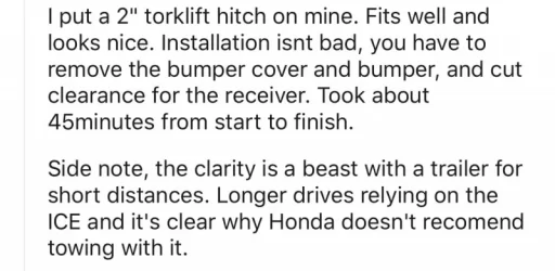

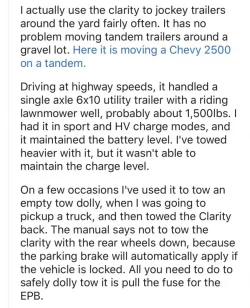

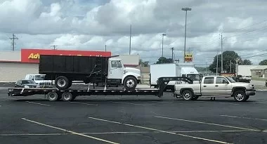

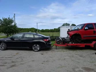

It’s settled people... the Clarity is capable of towing. I came across an internet posting today where a guy successfully towed up to 1,500 lbs.
Of course there are caveats...
I’ve attached screenshots.

@Heino, I'll probably never use the Clarity to tow: 1) because I haven't put a hitch on it and 2) even if I had a hitch on it, I'd fear the liability of possible accident with the trailer - too much litigation these days to make me comfortable, and too easy to argue that it was negligent to tow with a vehicle that was stated by the manufacturer as "not designed to tow" - there are limits for insurance liability and you are on the hook after that. All that said, I did like the info that if worse came to worse and the Clarity needed towing with rear wheels down, that you could do it by pulling the fuse for the electronic parking brake.

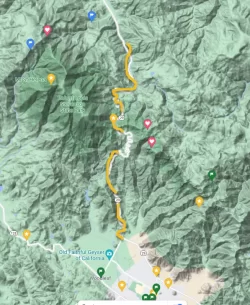

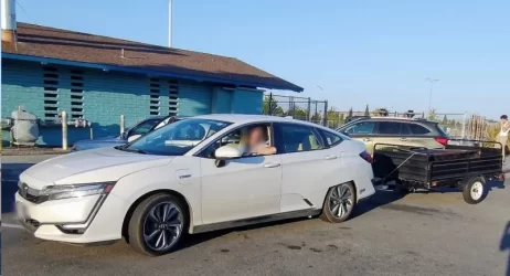

Towed this trailer up and over this mountain then back up and over, loaded with a cabinet and desk weighing a total of about 650 lb.
Tried both HV only and EV on way back (about 20 miles uphill on EV then HV).
No issues
https://detailk2.com/mmt5x7-info
ITEM NUMBER MMT5X7
PAYLOAD CAPACITY 1,639 LB (743.4 KG)
GVW 2,090 LB (948 KG)
CURB WEIGHT 451 LB (204.6 KG)
Regen downhill was good @Random.Clarity. No shimmying or weirdness but I was careful and kept good distance. After an initial fretting about it, everything felt good. I suspect that anything you do in EV mode will be good performance.
In ICE mode (whenever that occurs) you will have to think about RPMs and really be careful.
Obviously I do not recommend this to anyone, it was a test.
