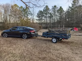

As a total noob, I successfully wired my Clarity to tow a 4x8-sized trailer. A huge THANK YOU to @Steven B for his patience in sharing his knowledge- it encouraged me to finish the process. Below is the shopping list:
  • My trailer - It's well built, it's light for a steel trailer (310 lb), carries 1340 lb (3/4 full of wet hardwood logs), lighting harness is already laid out in the plastic sleeves, so it's a matter of installing it (instructions are useless, follow your gut:). It comes with the steel sheet welded onto the chassis (no need for a heavy plywood, like with HF folding trailers), and most importantly- it folds nicely. I keep mine in the garage. I manage to fold and unfold it all by myself (I weight < 150lb). But it is heavy and it's quite a workout. Interesting fact: If you get it online it will come without the signed bill of sale. I had to go to Tractor Supply store in person to get one prepared. I'm new to towing, so it came as a surprise.

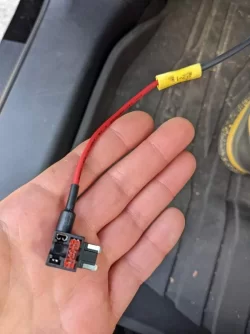

  • Micro fuse splice with 10A fuse - i got a 3 pack. Those fuses are total garbage, so buy at least 3 if you plan to pull it out. They just disintegrate, crumble in hands. Splices are ok, one will suffice.

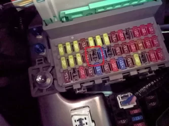

  1. The idea is to connect the wiring kit fully inside the car. You will need to conceal the black cable that will run from the converter (the black box of the wiring kit) to the fuse box (not directly to the 12v battery as in the diagram that came with the wiring kit!), (4) cables that will run from the converter to the left light and one last cable that will run from the converter to the right rear light. The converter will be placed in the area under the rear left light, under the liner.

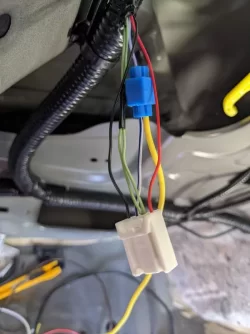

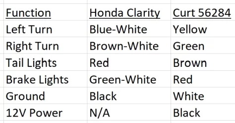

  3. Connect the wiring kit to the rear lights: There is no need to remove the rear light, only the plug. I stripped the tape to expose the individual cables that I tapped to, using these, which should be in your kit (see photo below showing one cable, right after i started the process). FOLLOW THE DIAGRAM BELOW (credit to Steven B!). Note two green coming to a single socket. Both are the stop light cables, you can connect to either one. The car light cables are super thin, so you may need to notch the cable sleeves slightly to help expose the copper inside, to make the splicer work. You will end up with quite a bundle! Pay attention to connect ground cables together! (I totally missed connecting those at first)

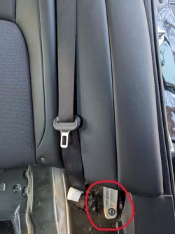

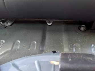

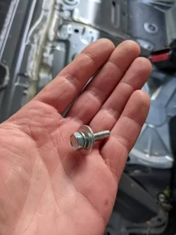

  5. Remove the rear seat to access the screw that holds the left vertical panel by the back rest of the rear seat. I had a pdf from some of the car seat cover manufacturer that shows the steps but lost it.. sweep the web and you'll find it. First, remove the screw in the middle of the seat, tucked on the back; see the photos below. Next, unclip (2) clips under the seat. Elevate and hold up by sliding in something rigid, to avoid one dropping back into its socket when unclipping another.

  7. Splice the black cable with the fuse splice. Install the fuse. Plug to the fuse box. Reconnect the 12v battery.

The only thing i did differently from Steven B was the way i spliced the cables to the rear light, because i used a different kit. Everything else is the same.
I'm a happy camper now!
Persistence pays off. You must have had a second vehicle. I would have given up and taken it to Uhaul.
We sold our second car last summer, it was all or nothing:) thanks again, Steven! We took another trip with the trailer yesterday - everything works like a charm, 40 electric miles, 36mpg after this at speeds up to 65 mph (trailer is rated at 45mph). The cheapest truck bed alternative!
