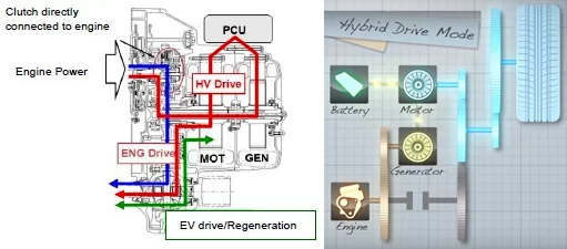

I have no idea if this car has any gearing whatsoever -- for all I know the generator might be direct drive off the engine's crankshaft. Does anyone know? I don't...
These two diagrams I found (one from Paul Tan's website and the other from Honda's i-MMD video) indicate that the starter motor/generator is not inline with the engine's crankshaft (left image), but permanently connected to the crankshaft through gears that step up the crankshaft's speed (right image).
