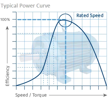

I'll try explaining it differently...this isn't a perfect illustration but I quickly found a generic representation (non Honda) of how RPM relates to power generation of a typical electric generator...it is very "peaky" to use language used when describing typical torque/HP curves:
Now...apply it to the Clarity. When your ICE first fires up due to electrical demand (HV mode activated either manually or by bringing EV range to zero), the engine is running, rather slowly for a bit. The engine is just warming up...get the oil circulated and warmed up for maybe 5 minutes before putting a big load on it...at this rpm yes the engine is running, but you're still mostly burning battery and EV range continues to drop. Let's guestimate at this point it's revving at maybe 1,500 rpm and not obtrusive. It is no coincidence that most gasoline powered cars, with today's modern high-ratio gearing and overdrive, are also often running at 1,500 or 2,000 rpm all the way up to 70 mph -- this is simply what modern non-aggressive drivers have become accustomed to...an engine that rarely exceeds 2,000 rpm in most driving circumstances.
But those engines aren't spinning generators. A brave new world.
Back to the chart. Most generators have a very specific RPM they are most efficient at. Naturally Honda would target this. And as a general rule it's in the 3,000 to 3,400 rpm range, but all are different. The other consideration is trying to provide a definition of "Angry Bees". For many, it might be as low as 2,500 rpm. For others, it might be 5,000 rpm. We have no earthly idea since Honda didn't give us a tach.
As stated earlier, when the engine first fires up and is walking along at 1,500 RPM and warming up it is entirely possible it is generating only 25% of the electricity it could generate if it were running at 3,000 rpm instead, where it is most efficient at producing power. Of course spin it at 5,000 rpm and it will generate even MORE power, but maybe only 25% more while burning 2 or 3 times the gasoline...efficiency drops way off. For generators: Extremely high RPMS are not efficient. And low RPMS are ALSO not efficient. Mid-range RPMS are most efficient.
So knowing this, what is the most efficient between these 3 options: Run the engine at 1,500 rpm for 4 hours? Or run the engine at 3,000 rpm for 1 hour? Or run the engine at 5,000 rpm for 45 minutes? All three produce the same amount of electricity in the end. Option 1 is more pleasant and quiet. But the 3,000 rpm run for 1 hour would burn less gasoline than either of the other 2 options. This is what Honda programmed into the car. And for this reason, I believe on typical high-speed interstate runs in HV mode...AND SOMETIMES AROUND TOWN...this engine very likely running in the 3,000 rpm range periodically -- and by design -- because it is the most efficient rpm for producing electricity after the engine warms up. The car's goal is to spin a higher RPM for a shorter period of time to save gasoline, charge the battery as fast as reasonable, and shut itself off so you can go back to saving yet more fuel -- and SOME owners report "angry bees" at this 3,000 rpm level because for the past 20 years they've been driving cars that walk along at 1,500 to 1,800 rpm at 70 mph...and cars that NEVER spin 3,000 rpm while coasting down a hill -- like the Clarity might occasionally do.
