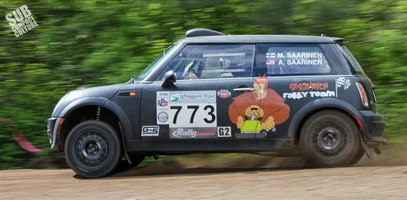

Here's a MINI designed to go fast on our forest roads (I'm not going quite this far though)
Also all I could think through the whole video is just how obnoxious those fart can exhausts are! Very glad my MINI doesn't sound like that.

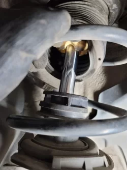

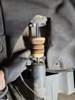

Got a chance to measure some things when swapping my summer tires. I guess it's semi-common but it seems the SE is riding around on the front bump stops even with the slight lift vs the ICE F56.
Front:
Shock shaft length: 5 3/8"
Bump stop length: 2 3/4"
Droop travel (from ride height): 2 7/16"
Free upwards travel: 3/16"
Rear:
Shock shaft length: 7.5"
Bump stop length: 3.5"
Droop travel (from ride height): 3"
Free upwards travel: 1"
