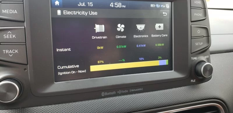

Today was the first time since I got the Kona that Battery Care/Cooling kicked in while driving..
95 degrees F and it came on during city driving.
Pulled 0.56 kw..
Almost looks like the chiller mode came on :

When mine came on today it drew 1.8kW! The first time I've seen that.
Interesting that mine only pulled 0.56 kw and yours 1.8kw. I did not hear anything coming on. All that I noticed was the draw in the battery sub menu..
Yeah, this is the first time I noticed it was drawing that much. All the other times it was only around 0.6kW. But good to see that it you're to cool the battery quickly if it has to.

Here is one just posted on Reddit
Temperatures higher 111 degrees F which is probably why the increased consumption.
