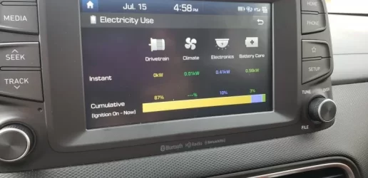

So today I had the battery care system come on for the first time (that I can tell at least).
The car sat for about 8 hours in the sun here in Vegas while I was at work. After work I remotely started the AC and drove home. Only about a 9 mile drive. I drove in eco mode and kept it in the "green".
Outside air temperature on the drive home was 37°C (98.6°F) which was after sunset.
So it seems to work great.

But how does the "Battery Care" kW reading know what portion of the heat pump HV power was being used for that purpose over "Climate"? Perhaps it is only, or additionally, 12V coolant pump power. I was under the impression that the Battery Care heading was for the battery heater, which I have but will never get used in our mild climate.

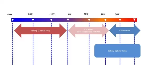

So, I drove home today without the AC (not happening again [emoji3062]). Attached is the screenshot when I got home. Just before I reached home the battery care system turned off, that's why it's showing 0kW. So I guess by the time I got home the battery was cool enough again. But throughout the drive it was right around 0.6 kW.
The climate usage was zero throughout the drive (actually it was 0.01-0.02kW). That's not even a lightbulb worth of power, so not sure what was using that little power.
After I got home I picked up my wife and getting groceries and turned on the AC. She wouldn't have liked to go without AC. However when I turned it on the climate showed about 1.5 kW usage! That was almost full fan and AC.
It would be interesting to see the difference on the GOM. But some sharp mind could probably calculate by assuming ~.6kW usage over a drive. I believe that should only be around 10-15 miles worth on the GOM for a full charge.
Hmm, so Battery Care didn't change significantly with cabin AC off.
Given the ability to discern cabin v.s. battery cooling power used on the trip with cabin AC, I wonder if the refrigeration loop cycles between the the cabin evaporator circuit and battery 'chiller' circuit rather than having both on at the same time. Noting in the elecricrevs.com article the two valves controlling those two paths. It might instead estimate the power split between those two areas if they are able to operate concurrently.
