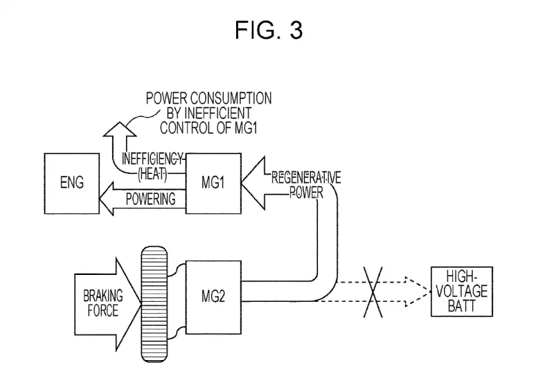

I am pretty confident that I have discovered why the ICE turns on after a full charge and other situations such as going down a large hill. While waiting for flight this past weekend, I decided to take a look at Honda patents. I stumbled upon "US10011270B2 Apparatus and method of controlling vehicle".
The short answer is that the car is protecting the battery when it is fully charged, or when the battery can't accept the amount of charge that is being generated at that moment in time, while still maintaining full use and functionality of the braking system. It basically dumps extra energy to the generator which tries to dissipate it as heat and if that is not enough, the generator powers the ICE. See the pictures below. The first two are from the patent and the third is from the document "Electric Powertrain System Desc 3107 :
For reference, I believe that MG1 is the traction motor, MG2 is the generator motor and the engine is the engine. Below are two snippets from the patent explaining what is going on:
...In this system, in an almost fully charged state where the regenerative power cannot be returned to the battery, the drive motor generates heat from the generated power and consumes the power, thereby compensating for insufficient regenerative braking force...
and
...and an engine reverse drive unit (inverter controller) that drives the engine by supplying part of regenerative power outputted from the drive motor to the motor generator. The regenerative controller can continue the regenerative braking even when all the regenerative power cannot be charged into the battery...
Disclaimer: I cannot specifically tie this particular patent to the Clarity, but it all sure adds up. Both the patent and and the Electric power train description are attached. Please feel free to look over and give your take on the information. Lastly if you want to look for patents yourself it is very simple:

AnthonyW scores again. I now confer on you the Order of Clarity Master.
I think you have finally found evidence to substantiate @insightman ’s most plausible theory on this. Here’s the quote for @insightman: “power consumed by engine reverse drive”.
@insightman is now awarded the inaugural Clarity Reverse Engineering Award.
That second doc is extremely informative and will give us a ton of info on the drive train system.
This also explains why the ICE doesn’t come on every single time you’re at full charge and have a downhill or significant regen due to braking.
I would have never thought to search patents for this. Well played sir, well played. We all owe you one (more).
Thanks KentuckyKen. Very kind words. :) I work closely with the R&D department at my company and the standard practice apparently when you have something new and cutting-edge you try to get a patent for everything. My flight was delayed a good while so I decided to just looking around. :)
Wow. I have been behind on the blog so I missed insightman pretty much nailing it 5 days ago in the other post. He figured it out without having to read poorly translated patent documents (come on Google, step it up). :) Thanks KentuckyKen for giving credit where credit is due. Insighman is the man here. :)
So are you. It’s a team effort to figure out our Claritys.
Many took the time to post their experiences giving @insightman the facts he needed to puzzle it out and then you did the detective work to find the proof for the theory and give us even more info.
Honors to all!

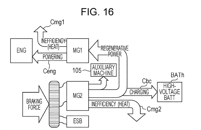

In the patent description, MG2 is connected to the wheels, so it must be the traction motor ("drive motor" in the patent) and MG1 the starter motor/generator ("motor generator" in the patent).
The patent says MG1 (the starter motor/generator) is "powering the engine" under regenerative braking when the battery is fully charged. The engine is described only as a "load." There is no indication the engine ever starts during regenerative braking. There is no discussion of MG1 reversing its torque to resist the running engine. The only reversal discussed is the reversal of MG1 from operating as a generator to operating as a motor.
So what I read was a description of what happens in the i-MMD Honda Accord Hybrids and Insight when the battery is fully charged. It could be argued that running the engine in the Clarity PHEV is just an exaggerated case of presenting a load to the starter motor/generator, but the starter motor/generator would have to behave differently to use up the power from the traction motor when the engine is running.
Alas, I didn't find validation of my theory that the Clarity PHEV's starter motor/generator reverses the normal direction of its torque while operating as a motor to resist the running engine during regenerative braking when the battery is full.
Still, a very interesting document. Thanks AnthonyW for your searching expertise.
