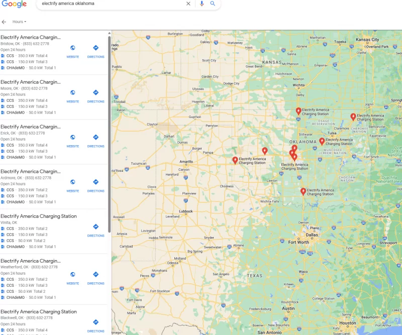

Then almost every one of EA’s sites must be considered “old”, or at least every single one I have ever been to. There are only 2 or 3 in the entire state of Oklahoma I think, all located on an Interstate, none on a US or State highway.

Suprised OKlahoma has this many Electrify america Stations.

The Canoo plant is in Oklahoma City, I live in northwest Oklahoma, 70 miles north of the EA sites on I-40. There are no other EA sites for almost 200 miles to the north along I-70. It looks like there are a lot of EA sites in Oklahoma but they are only located along Interstates, none on US or State highways, and there is a 200+ mile gap from Oklahoma City east to Clarksville, Arkansas, more than most EV’s can handle.

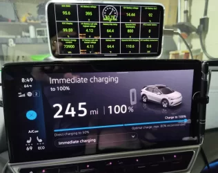

Do you have car scanner app to check battery temp and for bad cells?
I think you could increase cell voltage resolution to 3-4 fractional digits (double tap on screen > text size and color > numeric value format 0.####)
