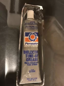

image.webp Only has my Clarity for 6 days and just got my ChargePoint.
I think I have the definitive (hopefully) answer for the folks whose charging handles are hard to insert and remove.
It’s clear that the o-ring is there to seal out moisture and engages toward the end of the insertion travel. This it is not the reason for any initial/halfway hard to insert/remove problems. Greasing the o-ring gave me a slightly easier end of insertion and beginning of removal effort.
But here is what really helped:
I put some dielectric (non-conducting) grease in the holes of the charging handle (first turn off breaker for safety). I did this primarily to protect contacts from corrosion and also to ease insertion/removal effort due to age and old arm injury. And it worked! Much easier that before. Think about it. The electrical contact between handle and car must be a tight friction fit to prevent arcing so it makes sense that it is going to require some kind of effort to mate up. Usually it’s not to bad but I have one public charger that a bear. Unless your handle is out of spec (SAE J1771) this should make it easier on you and keep you from having to remove the o-ring (think lawyers/insurance claim). You can purchase the dielectric grease at auto parts stores and use it on the o-ring as well. Please try this and let us know it it helps more people than just me.
Hope his helps and consider it my thank you for all great info I have found in this forum.

Ken, how did you get the grease in the holes and did you put it in all the holes? I'm wondering if this inhibits, in any way, the current flow.
Ken7, I used the old Mark I finger and Q tip on the handle holes and the Car male prongs. This does not inhibit current flow at all. I have used this on plug connections under the hood and in accessories I have wired in several cars. The pressure of the male to female blades or in our case, the round male prongs on the car port forced into the female contacts on the handle just forces the grease out of the way wherever there is metal to metal contact.
Our 110v included charger doesn’t have any o-ring that I can see and had very minor friction going in. It has charged O/N just fine w the grease. I primarily greased it for anti-corrosion purposes since it will spend its life in the trunkwell where who knows what the humidity/condensation will be there. It’s my emergency backup and I want it to work if I every need it.
Waiting on electrician to hookup the ChargePoint, but tested handle fit to Car and grease made it easier to insert/remove. Important to me since I have a surgically repaired dominant hand/arm.
So haven’t charged w it yet, but I can say that after greasing and plugging in several times at home and then using a free public charger (Level 2 Aerovironment) that charging seems normal. I think the last charge was 25miles to 48miles in 1 hr 15 min or less. Charger operated normally and got the above range on dash after it shut down.
Next week I will share results from home charging on ChargePoint on 40 amp circuit w 8 gauge NMB wire on about a 20 ft run from breaker box. I’m sure it will be normal.
Of course the grease won’t help if your plug is out of spec from the mold or perhaps has a spruce or seam causing an interference. Hope the folks w hard handle fit checked for this.
