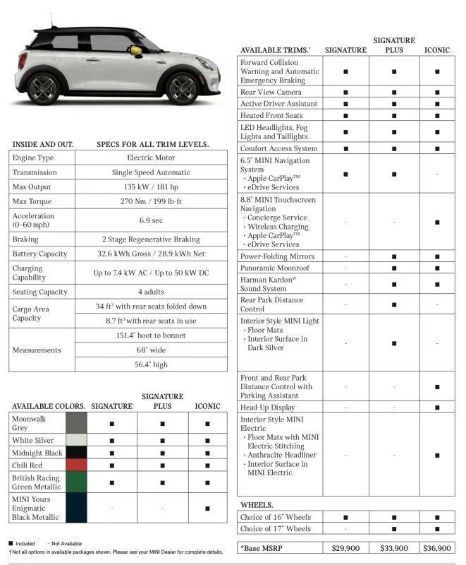

Perhaps an update, but I found that online summary missing lots of detail. In the ordering/feature brochure I saw in April, PDC was not listed as standard on the base. It was std on sig+ . The 2022 pricing PDF someone posted awhile indicates 507 (park distance control rear) was standard across the board. ... and then we have that recent 270lb-ft in the spec thing :)
Wow - I'm looking at a 2022 Sig coming in, and the build sheet does not have 507 PDC present. It would be very nice to have, although the dealer is convinced that it will have it on entry and that my deposit, or ahem, my committment to buy, would be refunded if it did not. I do find them quite helpful, particularly in grocery parking lots where you can't see in the rear lateral areas. Especially in a car as small as a Mini!

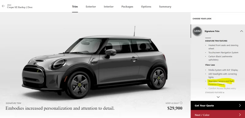

Hi All - I know this is a slightly old post, but I purchased a 2022 MINI SE in May, Signature trim, and according to the website and build specs thought it should have come with a few safety features that appear to be missing (Rear Park Distance Control and Active Driving Assistant). It sounds like a few others have experienced this and gotten only vague answers or the runaround from your dealers.
I took mine in for service, thinking it was just a programming error, and was told the Signature trim level doesn't come with these features, but that does not seem correct based on the website. Is this the same missing rear sensor issue others have experienced? Has anyone had any luck solving this? Is it possible to have sensors installed after the fact? Why would the dealer not disclose if there was a change in feature availability? Has anyone at least gotten a refund? Really wanted these features for safety - thanks if anyone can shine a light on this!
Parking assistant (5DP) is std on the iconic trim and is available as an option otherwise (so called driver assistant package).
507 Park Distance Control (rear) is std across the board.
Update: the service department confirmed that while the MINI website states that the 2022 SE Signature trim includes Park Distance Control, it is not installed on my car (even though there is the option to check it under the dash settings on my car). They said the website is wrong and the dealer should have informed me of this error. The dealer never told me anything.

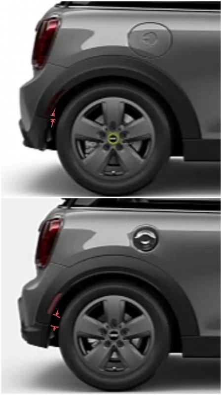

Here's an ebay seller who claims to have the genuine MINI electronic parking sensor parts (for a mere $187.90), but you'd need the special wheel-well trim pieces that have the angled mounting holes for the sensors. The seller does not indicate if the sensors can be added to a car that never had them in the first place.
All MINI Cooper SEs were supposed to have the rear parking sensors as standard equipment. Because MINI raised the ground clearance of the SE 0.71 inches (18 mm) to "ensure the relevant ground clearance for the high-voltage battery installed in the vehicle floor," they made the SE's wheel-well trim pieces wider to avoid unattractively increasing the space between the tire and the trim. When it became clear to MINI that they would not be able to include the standard rear parking sensors, they must have started manufacturing the wider wheel-well trim pieces without the angled holes. How long did that take? It wasn't simply a matter of deleting the sensors--they had to start making new wheel-well trim parts, which incurs the additional expense of new tooling, new part numbers, documentation, parts-stocking, etc.
IMO, rather than making this feature omission a secret that owners had to discover after paying for that feature and finding it missing, MINI should have made plugs for the holes in the standard SE wheel-well trim pieces and promised a retrofit when the parts became available. It is obviously the right thing to do. I'd love to know the full story about why they simply omitted the feature and pretended it never existed--without bothering to tell MINI's website department.

What I was saying was that when MINI decided to omit the rear parking sensors they went to the extraordinary step of actually creating a NEW version of the SE's wider rear wheel-well trim that didn't include the holes for the sensors. Or did they? Now I'm wondering, did MINI simply stick some existing earlier sensor-less F56 rear wheel-well trim on the SE even though it looks bad on the lifted SE?
If MINI went to the trouble to create special sensor-less rear wheel-well trim specifically for the SE, it does not bode well for the sensors to return as standard equipment when the chip shortage is resolved.
I can confirm my sensor-less Signature does have the SEs wider/taller wheel well trim. The wheel well trim from the ICE coopers will not fit as there are subtle differences by the bumper joint
I agree with @ColdCase that MINI likely already had the sensor-less parts for another market. Manufacturing tooling can also be quite complex with removable inserts to make different versions of a component on the same tool.
