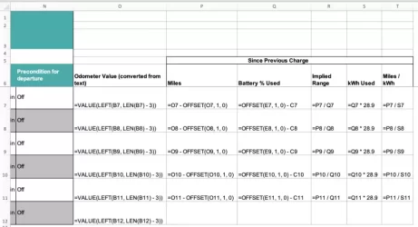

I'll make a version of my current spreadsheet that I can share. For now, here's a screenshot showing some formulas I just typed into an app export file to illustrate what can be done with the new odometer ("Total mileage") column.
Notes:
  • The first column added (column O) in the screenshot converts the "Total mileage" cell in the app export file from text to a value.
  • Cell P7 in the screenshot could have been =O7-O8. I use OFFSET so that I can insert and delete rows without messing up the formulas.
  • The text color for these extra columns in the download file needs to be changed from white to Automatic or black--at least for me the text was white.
  • Probably no need to say this, but the formulas are the same in all the rows--just copied from row 7.

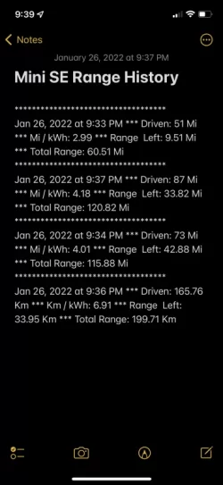

My Range video (link in first post) has been updated with a new version of the Range calculator - Mini EV Range 2.0 IOS Shortcut:
Version 2.0: 01/26/22:
1) Fix a bug in calculation when starting battery less than 100% (thank you, @Puppethead )
2) Add miles/kilometer prompt
3) (thanks to @fasttr ) Shortcut writes log to IOS Note: You MUST CREATE a new IOS Note with title “Mini SE Range History” before the calculator will run correctly
IOS Shortcut direct link:
https://www.icloud.com/shortcuts/9a174a4fd8dc472d9dc21404c3aa293e
Let me know if you have any trouble. Thanks!
Note example:

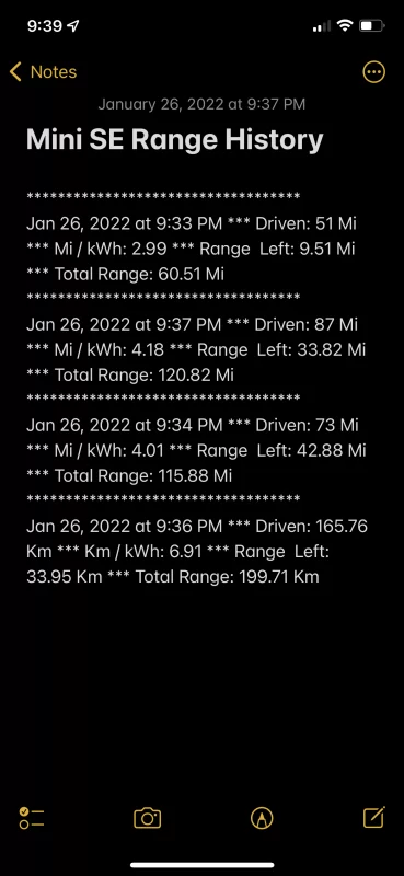

Note example:
Cool! I was wondering how to keep a log of the data. I just screen shot and saved in my photo thinking one day I will plug them into a spread sheet haha. Thanks for the shortcut!
