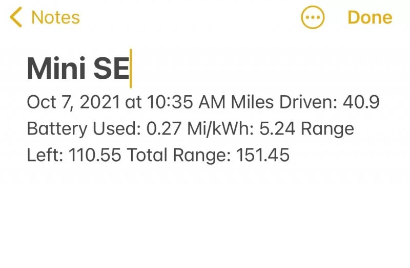

I added a couple of steps that allow you to keep a history of your calculations in an iOS Note. I don't want to publish my shortcut as it is mostly your work but you should consider adding it to your original work.

Well guess what iOS 15.0.1 has broken the Append to Note action in Shortcuts. Apparently if you do not have a calculation in your shortcut it works fine. So will have to wait until (hopefully) the 15.1 release. In the meantime it still works on my iPad at iPadOS 14.7.

Sorry - I almost missed this in my notifications list. This is great!! And I saw your next comment about IOS 15 breaking it (ugh!). I would love to update my shortcut, and I'll give you full credit! I can update the video description. Can you share a link either here or send me a message with the changes? Thanks.
EDIT: This shortcut is for the public and I don't mind if you publish it yourself, as well. (In other words, I don't mind if people copy it and post it, etc) It can always be improved. Should probably add an option for km or miles, too. I just haven't had time to look at it.

iOS 15.0.2 - still broken [emoji45]
