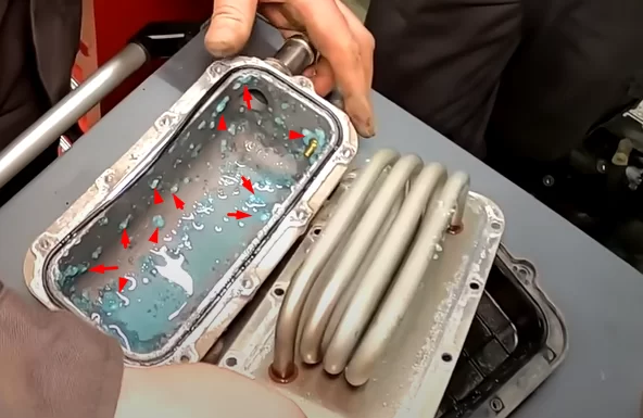

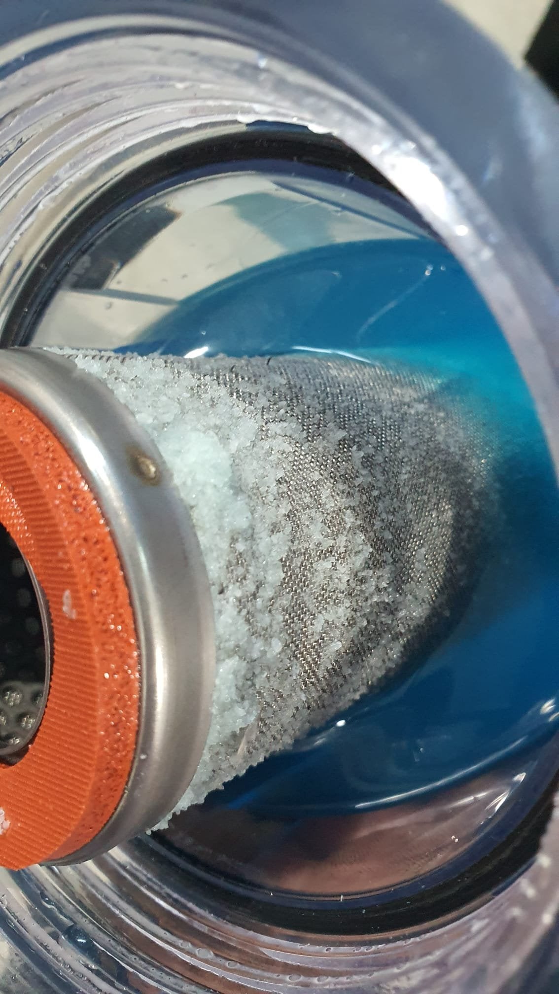

Picture of coolant change showing crystals separation from SpeakEV forum :
img-20230727-wa0138-jpg.179906

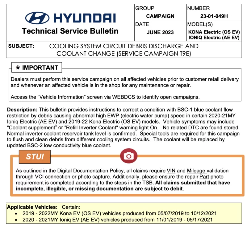

After 3 attempts to contact the dealership's service department, including leaving 1 voicemail which apparently didn't accomplish anything, I finally talked to someone before next week's appointment. Apparently, they do have the special pump and have performed the TSB previously, but they will need to confirm that my car has indeed thrown the warning messages before they can proceed with the TSB, so I'm assuming/hoping the diagnostic will show that the message has come up. It hasn't appeared in the last couple of weeks.
They should also be aware that I'm eligible for the BMS update (9A4 recall), but I don't know if they will be able to also do that. They make use of the online scheduler and if you select the BMS update, the soonest appointment is February. The next-closest dealership has a much sooner appointment window, but I'm opting for the closer one because I can actually walk home from there while the other one is outside their "free" Lyft service range.
Well, I took it in this morning and they said they're going to perform both the Coolant Change and the 9A4 DTC Inspec / BMS Update. We'll see if I get it back before EOB. Interestingly, I got a Bluelink notification for the panic alert a few minutes ago from the dealership address.
Not terribly surprising that I did not get the car back yesterday, but they did finish first-thing this morning and I have it back. No issues after driving around for ~10 miles. The notes for the coolant change (DEBRIS DISCHARGE AND COOLANT EXCHANGE) on the invoice were:
"performed recall T9E coolant system and coolant change, using s/w update performed air bleed and photos uploaded to stui."
