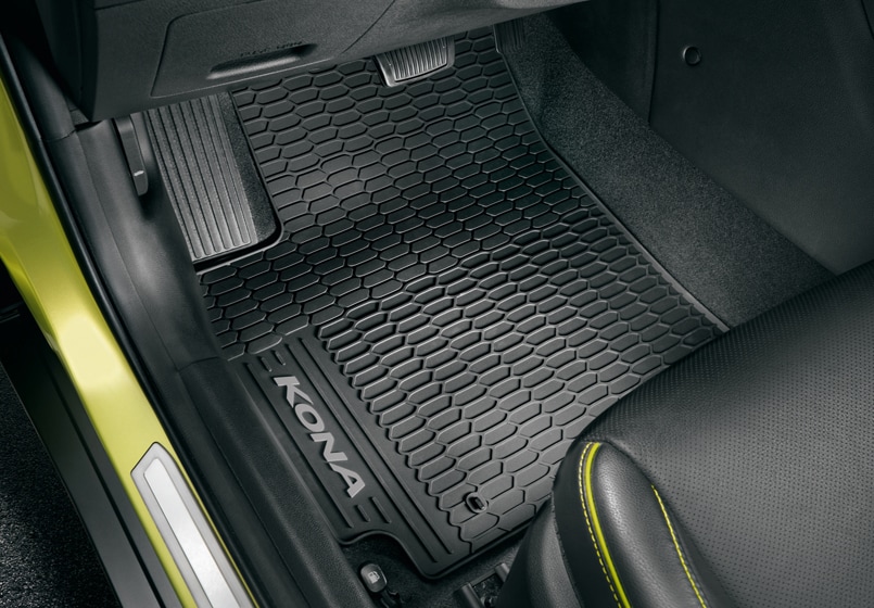

Following up: My visit to the dealer today revealed that, yes, my accelerator pedal assembly is, once again, faulty. Apparently the module has been redesigned and is on back order. The redesign might indicate that something was amiss with the original component(s) that failed although I don't recall any mentions of this issue from other owners. They also suggested that my aftermarket rubber floormat may have been at fault since it was apparently pushed up under the accelerator pedal pivot point - although there's no proof of any connection. I am driving the car while awaiting the part and hoping this intermittent problem doesn't reoccur at an inopportune time or place.
Amazing what pitiful excuses these guys come up with, just to avoid warranty repair. I also use non-OEM floormats and looked under the dash to see , the clearance from mat to pedal is at least 2-3 inches, and well below the OEM carpet that rides up the firewall, If there was to be any incursion, the mat would have to ride all the way up to just below the mounting bolts holding the pedal assembly in place, and if it did there would be more of an issue as it would interfere with the steering linkage. BTW, my $20 set provide more protection, fit better and are more cost effective than these offered by Hyundai: At least your problem will be covered by Hyundai hopefully in warranty and at no cost out of pocket.
I did I trimmed a window out of my mat around the pedal area. It was a small matter and the mat still provides plenty of wintertime firewall coverage. And who knows, maybe it was interfering with something? In their defense the mat issue was not brought up in a punitive manner and there certainly was no inference of blame. And, yes, it's all covered under warranty.
