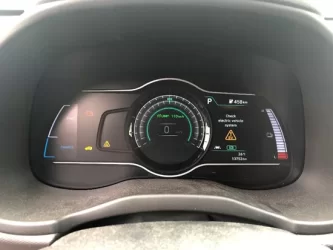

  1. Are you the owner of a 2021 or 2022 Kona Electric who has gotten this message on their dash?
    If so, please respond and post. Basically, I am trying to find out how widespread this issue is.
    I received the message about 3 months after buying my 2021 Kona Electric (13000km). It stopped my car from moving and had to be taken to the dealership for a battery replacement. The dealership did a full investigation of the BMS (took about a week) and the result was I needed a entire traction battery replacement. So, it has been 7 weeks and I am still waiting with no end in site.
    If you are in a similar circumstance, please come forward and post. I have seen several posts on this forum already from other users and encourage them to tell their stories.
    Create an account, and tell your story.
    Thanks and take care

  3. The service manager at Hyundai didn't have alot of details. His comment was that after the 2019-2020 fire issues, the battery management system was updated as a safety precaution to more "rigorously check" and detect cell/pack anomalies early (and prevent a fire). The error came up in the morning after I had finished charging in my garage overnight. The BMS detects a potential safety issue and then disables the vehicle. BMS did it's job. Then the vehicle goes to the dealer (on the back of a flat deck tow truck) for full BMS/battery inspection with the specialists (from head office) remote desktopping into the local dealers system. The specialist's conclusion (after running the test twice) was that the battery needed replacement. They can't clear the code because it is a real "physical" issue internal to the battery. Vehicle can't be driven, "do not pass go and do not collect $200" and so I wait in the long line up for a new battery 7+weeks and counting.

  5. Do you know what code the car threw? I've been dealing with P0B5900 that has surfaced twice on my 2021 but "fortunately" has not bricked the car yet!
    NS KONA Elec likes this.

  9. My particular OBD2 is not compatible with the Kona EV but rather got the code from the invoice given to me after my 2 visits to the dealership. More specifically it states "Battery Voltage Sense "G" circuit".
    In my case it seems to be an intermittent fault and am simply waiting for it to pop up at a moment where I can bring it in and have them witness it first hand!

    After two weeks of no car, I picked up my car today.
    • No charge on the fix (which took 15 minutes of tech time, but two weeks to get the appointment and 1 week sitting on their lot).
    Tech found DTC P1AA600 code
    Perfomed BMS (Battery Management System) Logic Upgrade 00D118RA
    • I think this was entirely a software update.
    Some details from Hyundai about recall: HMA TSB (nhtsa.gov)
