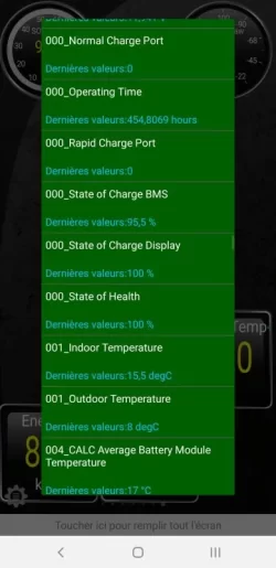

Not sure if that interest anyone, but I checked with my OBD scanner to see what 100% charge was and it looks like it's ~95% of the usuable capacity of the pack. Here is a screenshot of the torque app.

It would at 3.63 V per cell. I'm wary of calculating an exact kWh rating because it's entirely dependant on what average cell voltage you choose. At 3.7 we have 65.2 kWh for example. No doubt there is a real v.s. 'virtual' range of SoC as you say but I think it's quite irrelevant to us as consumers and possibly even Hyundai as a systems integrator. LG Chem have to meet the performance spec as a vendor to Hyundai and any over capacity is their ace up the sleeve ... if you see what I mean. The "40kWh" Kona battery is rated by Hyundai at 120 Ah so you can see that it has 2 cells in parallel.
