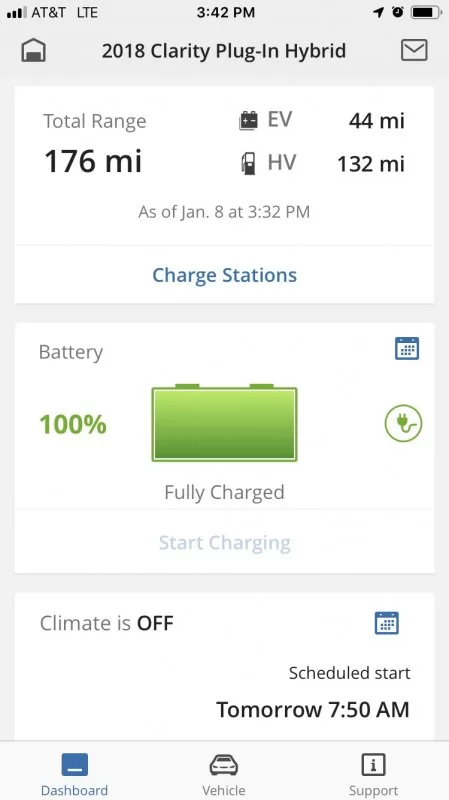

Now it is showing 44 miles with full charge. Happy with this number( covers my full commute)
I am not an expert but looks like battery took 10 days to report this 44 mileage. Not much difference in other factors.
Initially 37 then 38 then 42 then 44. Hope it reach advertised 47 miles on full charge in Houston.
Yeah its learning your driving patterns so the estimate gets better. If you drive it hard / crank the heater/AC for a few days it will drop quickly :)
So sounds like it was originally driven harder (test driving) and you are now more economical so its going back up.
Maybe history is even more important than temperature.
