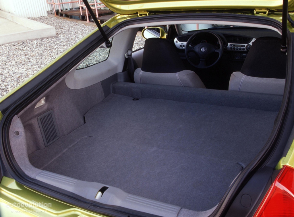

Yeah, but the gen 2 Insight has a back seat and some actual room in the back for luggage... both of which the gen 1 Insight was notably lacking!
The first generation Honda Insight HEV, showing the lack of rear seats and the shallow cargo space above the large NiMH battery pack.
We have a 2006 Insight (85 mpg personal tankful record) and a 2010 Insight (48 mpg personal record). No one bought a gen 1 Insight only to be surprised it didn't have a rear seat. Honda went all-out to create a bespoke, all-aluminum, 70-mpg (by 2000 EPA standards) car, then sold it in the US for about half what it cost to build.

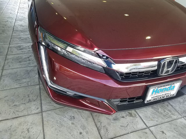

My Clarity was damaged in a collision with a deer and I have the repair cost including replacement of the battery listed as part# 1D1005WJA02 at $6,101.97 plus about 15 hours of installation labor. I don't know if this is MSRP or a price negotiated with my insurance company. Incidentally, with what looked like minor damage to the right front corner of the car, the total bill came to over $20K!
