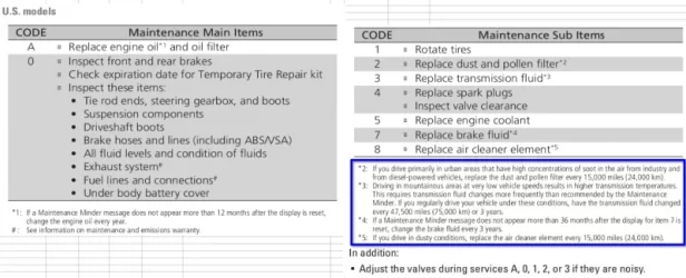

I’m opening this old thread because it was just hammered into my thick head how little dealerships know about this car. I had to do my A012 service as my car hit its anniversary and passed 30k miles. I do my own tire rotation ($0 vs $75) and change the engine and cabin filters ($30 vs $150). Basically this means an oil change and general inspection for $70. The service department said that I needed a $520 service as my car was over $30k miles. They tried to hit me up for brake and transmission fluid changes plus whole host of other stuff ever though the car maintenance minder AND the owners manual don’t support it. Who knows how many people get scammed this way.
Brake fluid replacement is recommended every 3 years (in the manual).
As for transmission fluid, the manual states that fluid should be replaced every 3 years or 47,500 miles if driven under 'severe' conditions.
Otherwise you should go by the maintenance minder which would be a code "3".
Here is the relevant snip from the manual:
When I query my maintenance data through the OBD2 port, it tells me that I have 805 days remaining before transmission fluid replacement is needed.
This would be November of 2024 (6 years from original purchase date), so it looks like if you don't have severe conditions as described above, it would be 6 years.
