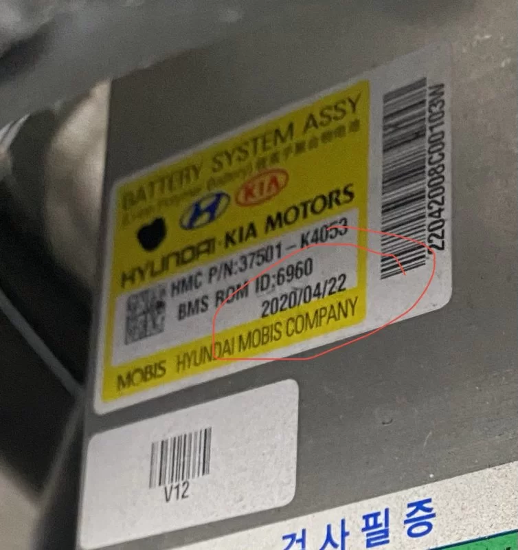

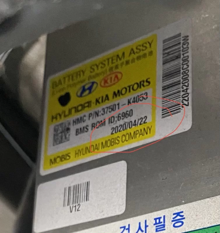

How do you know when your battery was manufactured?
If March 13th 2020 is the cut off date, that must mean they have solved the problem with cars manufactured after that date - or does it??
You have to look up under the car. Crawl up from the back and look on the left side of the silver battery housing. The label is bright yellow.
You have to look up under the car. Crawl up from the back and look on the left side of the silver battery housing. The label is bright yellow.View attachment 10980
Interesting. My car
My car manufactured 2019/06/19 has a WHITE label with the date: 2019/06/13. Hard to believe the battery was made only 6 days before the car.
I have yet to see a Kona EV with battery manufacture date later than car manufacture date (unless it was obviously replaced);)
