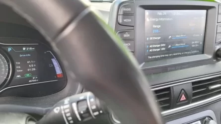

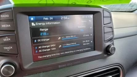

Hmm.. in the article, it said the BMS update limited our charging to actually 90% of the battery. I don't recall this happening, as I think I've charged to 100% without noticing any range degradation. Did others notice anything?
I didn't notice reduced range from the updates.. Still charging to 100% and 4.17 volts per cell..

I fast charge A LOT.. No issue at all after over 135 fast charges.. This is my estimated range right now..
