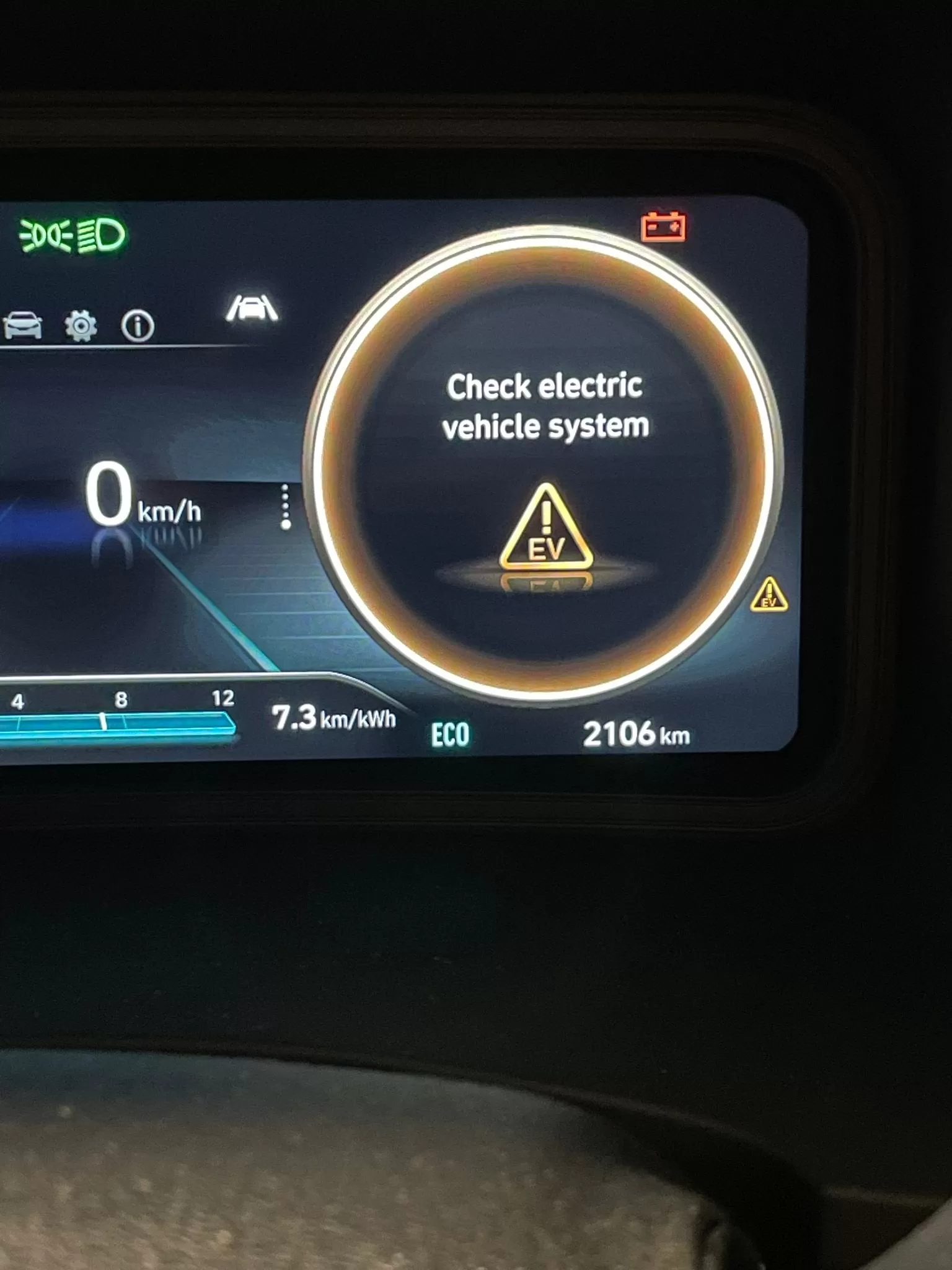

whatsapp-image-2021-08-13-at-08-30-29-jpeg.5817
Source:
https://www.hyundaikonaforum.com/threads/2021-22-kona-ev-battery-manufacturer.5027/page-2#post-40543
Somehow I feel a 12V reboot won't solve the problem:rolleyes:

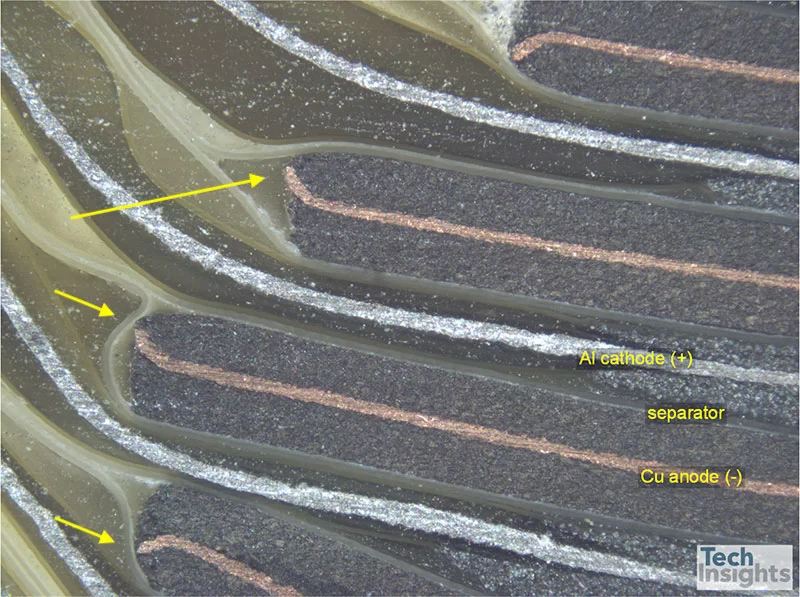

The recall info on one site indicates that these are Bolts that have two concurrent faults, a torn anode and folded separator. We of course believe we only have the first defect and I haven't seen a definition of the second. It's not clear how Chevy dealers will diagnose either of those.
My recent realisation is that the construction of a pouch cell is a bit random for something that relies on geometric precision for safety. I don't recall if I had posted this photo before (which I have annotated with the 3 yellow arrows at the left) but you can see how some edges of the anode gets very close to the separator. This is what I think is the "folded anode", an edge left when cutting folded copper sheet part way around a bend, simply an artifact of a production shortcut. The photo happens to be of an older Bolt LG cell.
I remember that picture being posted on a different forum some months ago and was hoping you would post it here as well. IIRC there was a link to an engineering page, would you be so kind as to include that source?
Thanks:cool:
