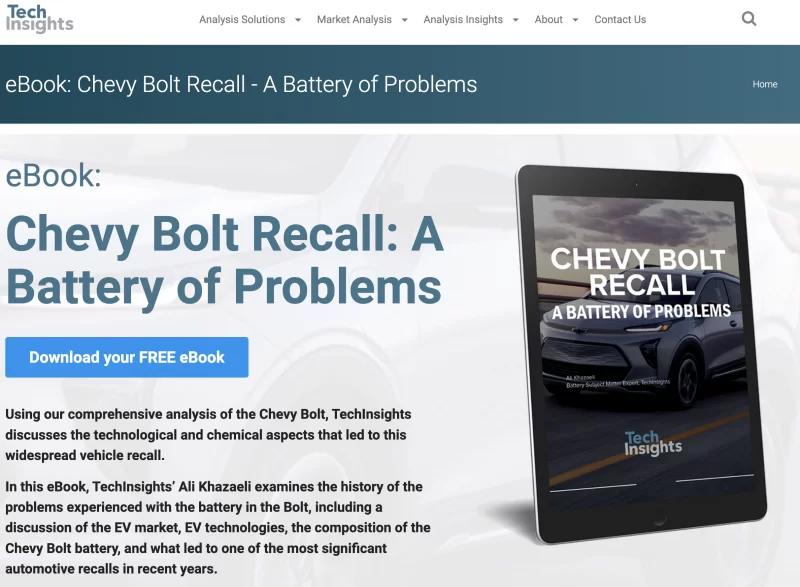

Further to that there's an industry report on the Bolt defects, not identifying a proven root cause but giving some strong hints including what I mentioned in post #17. You need a non-free email address to download it.
