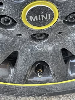

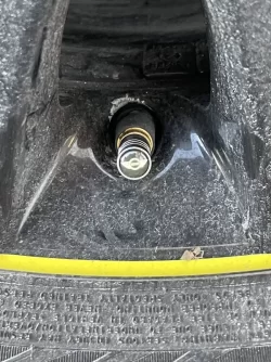

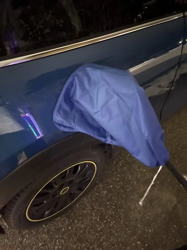

We are supposed to get a light snowfall tonight, and I have to top up for a 200 mile drive tomorrow, so I’m trying out my magnetic charging port boot for the first time.
I like that. Where did you get it? Found a Yet-E-Boot for 85.00 but out of stock till the 9th of dec.

Please pardon the dirty wheels, it’s been sloppy this week
Sourced from Amazon, shipped from Asia. $8 a set, took five weeks to get here. Got a second set for when the Power Spokes emerge from hibernation.

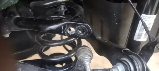

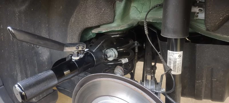

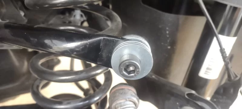

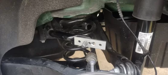

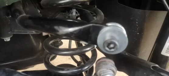

25% RARB stiffness increase. $0.00

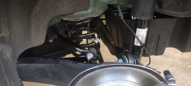

1. I was a little dubious that I want a stiffer RARB for the street, so didn't want to spend $$$muchodinero on a new one, then have hours of fun of getting it in.
2. I might want a stiffer RARB for autocross.

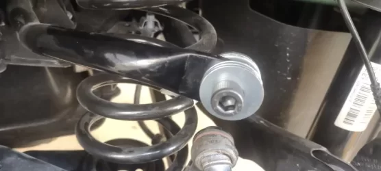

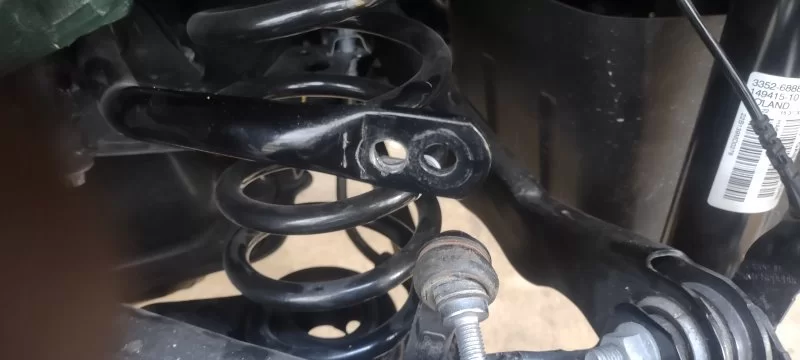

Solution, add more holes to the stock one, and see how I like that.
Moving the holes inwards 16mm makes it 25% stiffer. It won't be quite that high as the linkage geometry is messed up a little, maybe 24%

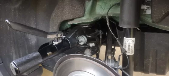

I made a little drilling jig from an 8020 joiner.
The RARB is tough, hard stuff. You are not doing this with Horror Fright drill bits. I used some nice cobalt ones. The 13/32 I resharpened multiple times.
Squishing it flatter. One tool was an M10 bolt and washers. I wanted to minimise how much I squished, I don't want this cracking. The other tool was a hydraulic terminal crimper. I think it is rated for 10,000lb. That worked better than the M10 bolt. Best result was the side that I first squished with the bolt and washers, then crimped. One of my holes drifted downwards a little. But once the RARB is bolted back up, nobody will ever know.
I took it for test drive to some big box stores. I wasn't able to ahem, 'properly test' the cornering, but it feels pretty good at about 80% fun level. I really don't think I want a stiffer one for the street. The ultimate test of this will be the colour of my underpants after my next 80mph interstate moose manoeuvre.
So far, I really like the feel of it. Steering is much more direct, car feels a lot more neutral. It feels like it has more grip at the front.
Those who have have a pathological aversion to modifying parts, may like to know that the NM engineering solid 22mm is going to be very similar stiffness, on its softest setting.
If I decide this is a good stiffness for the street, but AX needs more, I'll get a solid 22.

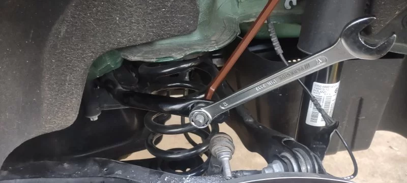

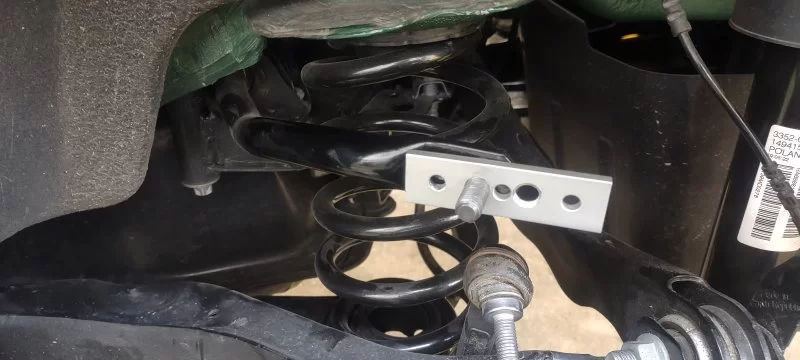

View attachment 19059 View attachment 19061 View attachment 19062 View attachment 19064
View attachment 19065 View attachment 19068
Update. I took it to another autocross today. It was not much above freezing, so I ran my Nokian WRG4s. What's the worst that could happen? Oh, the toilet block, or the fire hydrant?
Times weren't great, my driving had a lot to do with that. I was more cautious this time, starting slow.
The car felt much better to drive. Very controllable. Get a little fast, I could just hold it a little sideways until I wasn't. No ploughing straight on today. Enough rotation that I'm going to leave the rear bar at its new 25% setting, for now. I had tyre pressures at 38F, 42R. So I may be able to go larger on the rear bar down the line. I only did 5 timed runs today, so didn't get to really hone my piloting like last time.
My R53 is also very , very chuckable with skinny WRG4s and a stiffer rear bar.
I don't think the Nokians have the outright grip of the stock 'Kooks, but they handle great in the dry. Perfect for an autocross noob.
Up first will be -0.5° front hub carriers and some proper 200TW autocross tyres.

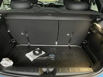

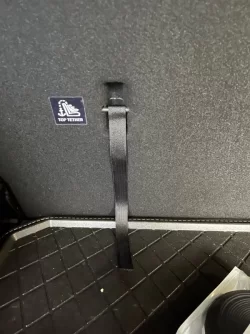

Here’s the dumb one mentioned elsewhere. Cut two strips of self-attaching Velcro (ie the hook and loop are both on one side, the other side is smooth), and affixed them to the child seat tether points. Easiest “mod” ever.
