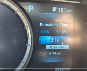

Well i drove down to freedom town in WA, they have 350kw chargers there, i was able to get 79kw charging, it would go from 76-79 but yeah nothing like here in BC where i dont even get close to what they say they can offer.
