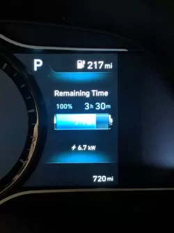

I get 6.7kw with my Bosch PowerMax 30A

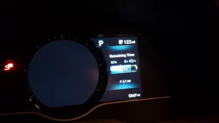

I'm not sure what's up with my EVSE. It seems to be charging faster than it should. My EVSE only has 2 amps more than yours and I'm charging at 6.0 to 6.1 kwh.
