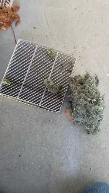

After having our car in storage (garage) for 3 months I opened the car and smelled this putrid/urine smell. Sure enough the bastards set up an encampment just above the air filter. The filter was used as a litterbox. The insulation was the insulation from the footwell area. I have an appointment with an interior detailer who has experience with this type of thing.
BTW, the traction battery only lost about 2% SOC over the 3 months here in Michigan. I had my battery tender on the 12v battery and the car started right up.
Sent from my SM-G955U using Tapatalk
I’m still thing to figure out out those sneaky bastards got in there. Maybe the hood hinge opening is not separated from fresh air?

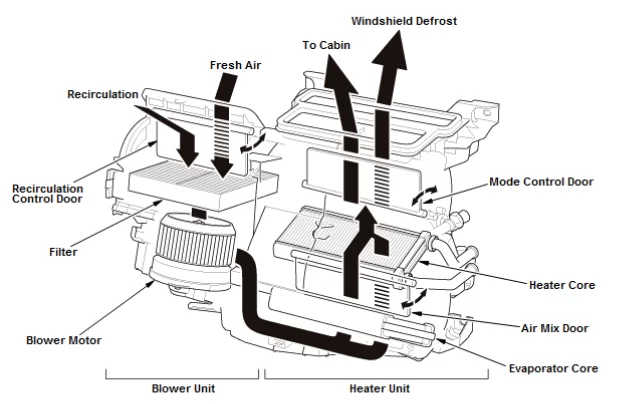

Here is a diagram:
The fresh air comes in from the 'top'.
My guess is that air comes through the vents at base of the windshield (between the windshield and hood, where the wipers are).
Now, the question is - Does a rodent have to come in that way?
If a mouse gets in (could be from anywhere) there are many opportunities for it to enter the duct system through an interior vent.
It is surprising how little of an opening is required for a mouse to go through. There may be easier ways for a mouse to get into the vehicle from the bottom of the car than to climb up on the hood and enter the intake vent, but who knows?

I didn't slog through all four pages of posts, but saw something above about the "recirc method" or some such. If that means remembering to put your HVAC system in Recirc mode prior to shutting down the car, you may be fooling yourself. Failsafe for automotive HVAC systems is Fresh Air/Defrost/Heat. What that means is that whatever motive power is responsible for making your HVAC flaps move (be it electricity, vacuum, or something else) when it goes away, is turned off, or otherwise fails, the flap that does fresh air/recirc moves to fresh air, the flap and/or water valve that determines hot/cold moves to hot and the flap that directs air to the windscreen through the defrost louvers, or blocks it sending it to the dash or floor vents, opens to defrost.

Here is a diagram:
So if I found mouse feces atop the cabin air filter, doesn't that mean the mouse couldn't have entered from below the filter, since the filter was intact, as was seemingly the case with others showing undamaged filters? (It was squeaky clean, pun intended, under the filter.) If so, that means the mouse had to enter from above, and the only opening to the outside world I am understanding there to be is the fresh air intake at the cowl. Right?
Of course, this assumes the mouse didn't eat through a duct to enter -- all bets are off in that instance.
I'm going to check to see what happens to the recirculation control door (as shown in the diagram above) when I turn the car off when recirculation is ON. If it opens to fresh air, then indeed, using the recirc method of defense won't work, as AHolbro1 explained.
Without going through or around the filter, a mouse would need to enter through the intake ductwork in order to arrive, and set up camp, on the intake side of the filter. From the outside there is a fresh air intake, inside the cabin there is a return air intake.
