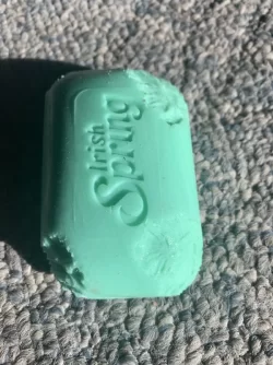

Laying a SCENTED dryer sheet on top of the cabin filter may help. We put shavings from a bar of Irish Spring on a cookie sheet in the trunk, and it smelled good, and seems to be helping. At least, no more mice inside the car that we can tell. Still wondering, has anyone come up with details for metal screens over suspect openings? Both engine and cabin air intakes, and . . . wherever else needed. Tnx.

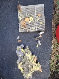

How did you get Mama Mouse to pose for this picture ???
I think this is the best (worst) example yet. Do you park outside ?
Yes, I park right outside my attached garage. We have bait boxes in the garage...
I live in a semi wooded area so its an ongoing battle amongst these guys getting into enclosed trailers and toys, equipment and vehicles.
