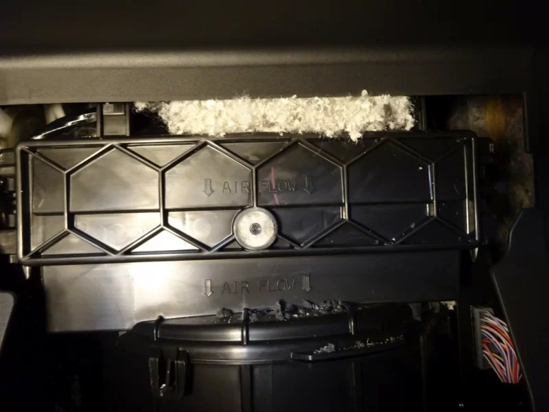

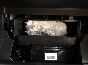

I’m still thing to figure out out those sneaky bastards got in there. Maybe the hood hinge opening is not separated from fresh air?
ARRRRGGGGHHHH...
ME TOO !
Better go out and check yours too !!!
There were a few acorn shells in the fray, but my best guess would be a mouse.
I now have some mouse traps set just in case he (she) is still mousing around.

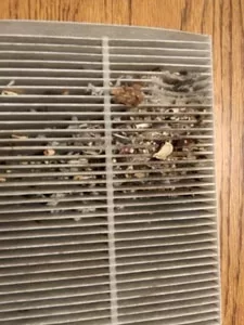

Great thread. Made me realize I hadn’t replaced mine in 2 years but since I don’t run much heat in the winter it’s really more like 1 year of normal use.

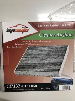

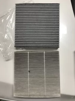

As you can see, it wasn’t that bad. I bought a cheap aftermarket filter because of the price and the fact that it has some activated carbon in it. Well, you get what you pay for. Notice the Honda OEM has 40 pleats and the cheapo has only 28 which is 30% less filtering area and has no glue strips keeping the pleats apart. Won’t make that mistake again.

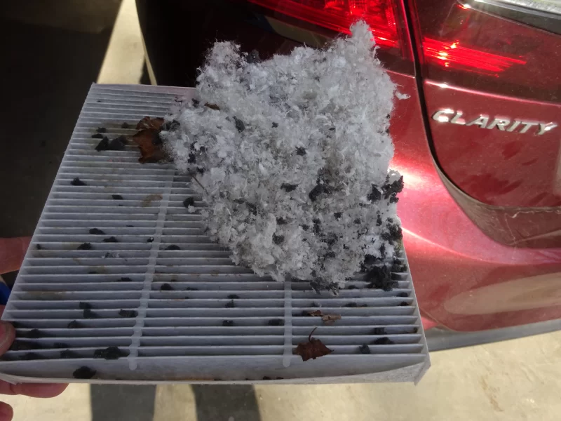

As a follow-up to post #6 (4/16) above...
I cleaned out the nest, and ordered a replacement filter. I set some mouse traps (no, not the humane ones... The old fashioned spring-type) just in case the little bugger was still around (either in the car, or the garage). I had not gotten any 'hits' on the traps, and figured my problem was solved.
I Received the new filter and installed in on 4/22.

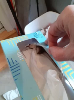

Yesterday, we brought home a nice pizza with white sauce and broccoli.
Today, I thought something smelled a little off. I asked my wife to go do a 'sniff test' in the car. Her conclusion was that is just smells like the broccoli from the pizza. But... after driving for a while, she got a stronger whiff. Definitely not broccoli !!!
We keep a box of tissues on the shelf under the shifter console. It seemed to be emanating from there...
Well, investigating this after we got home, to our great dismay, we found the source of the aroma... It was a dead mouse, all curled up inside the tissue box.
Not to be morbid, but rather to convince others to take this threat seriously... Here is what you could be faced with:
Once again, I strongly suggest (if you haven't already) - Take a look at your Cabin Filter to see if you are at risk for this sort of thing.
It is surprisingly easy to do. There is a very good video in another thread (no tools required). You can see it here:
