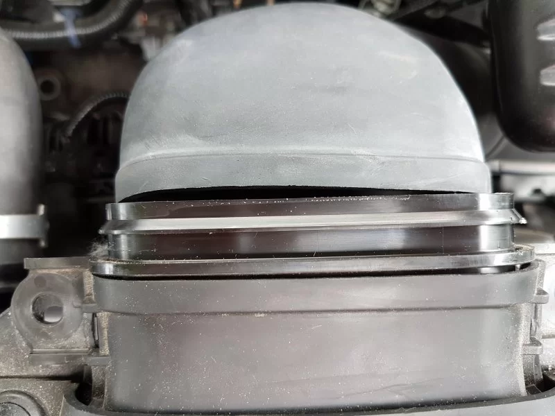

The rubber duct can be pulled off without removing any clip

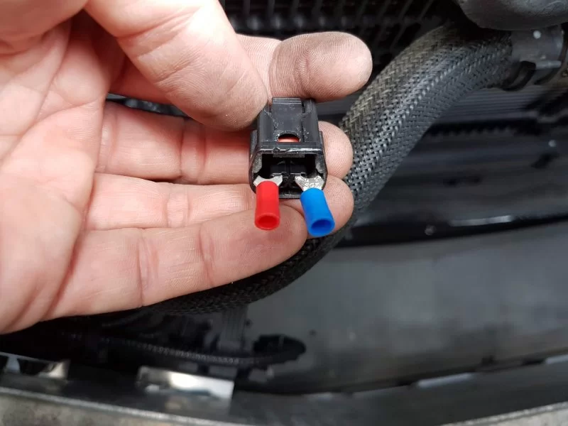

For those making your own adapter the ground pin is blue (in the photo)

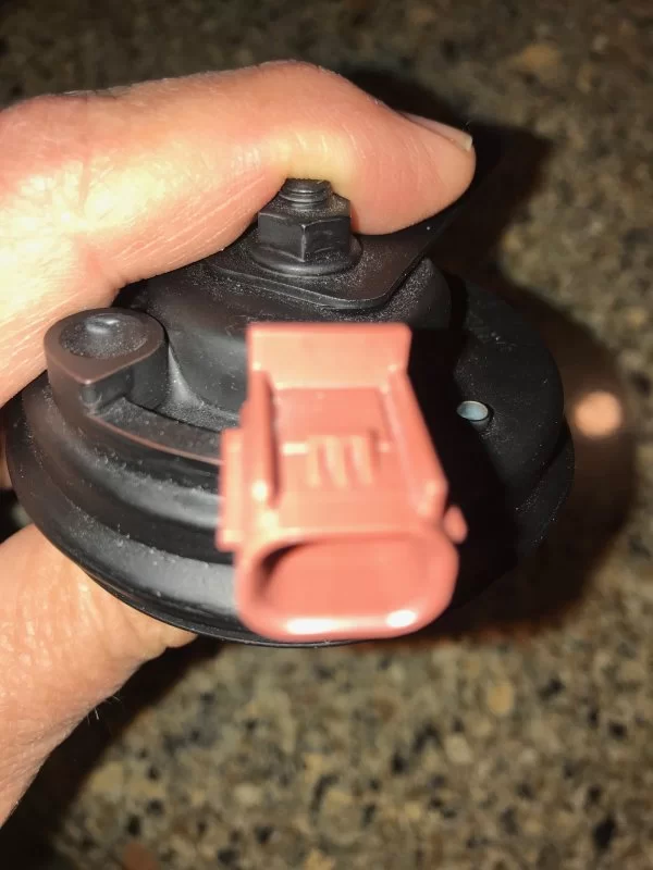

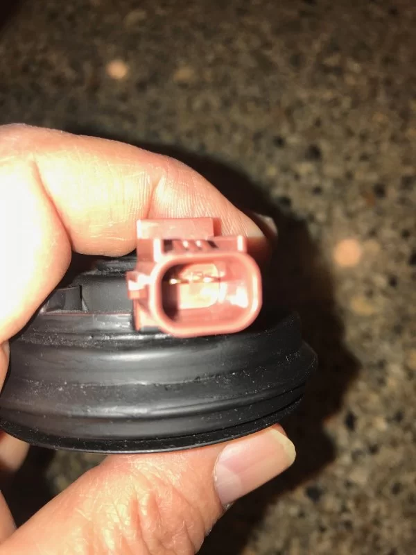

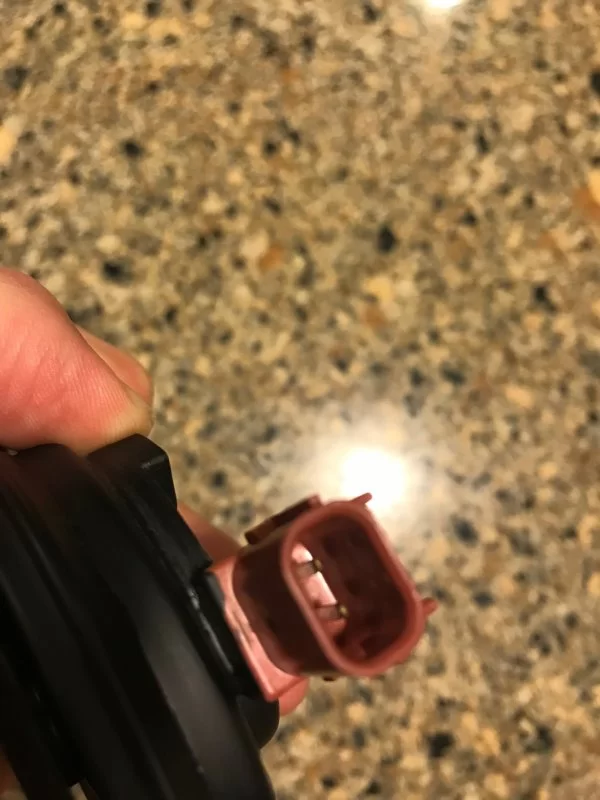

PeteWagner: Thanks for the 2-pin vs 1-pin comment. I have to order something from College Hill Honda, so I took a small gamble and ordered their 2-pin "Honda horn adapter" harness (https://www.collegehillshonda.com/product/0S18.html). I'll let the forum know if it fits.
Adapter above works!

-I didn’t need to remove the air intake hose. Was flexible enough to twist the cover out of the way.

Ditto on that adapter. It mates perfectly to the OEM connector making for a very clean install and no alteration of the factory wiring.

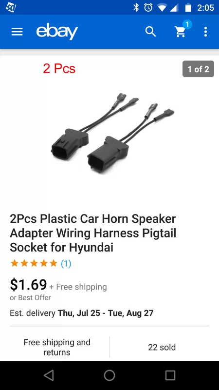

Would this 2 pins adapter works? Significantly cheaper, but long shipping time.
Can't copy the url, but price range from $1.69 to $2.8
