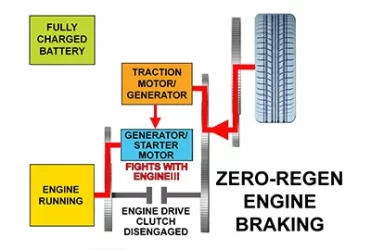

BTW, one situation when the friction brakes are used exclusively is when the car is fully charged to protect the battery. So if you want to maximize regen and maximize battery longevity, avoid fully charging your battery.
