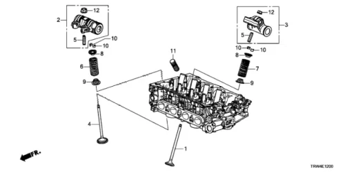

Not to dig up an old post, but I want to learn how to do this adjustment myself. I found this information on one of Honda's parts websites, and it specifies the adjustment stud bolt on both the intake and exhaust sides.
Has anyone been able to find any more information on the proper clearance and torque specs for a Clarity lash adjustment?

Thank you very much. It seems to me that the previously attached document may not be correct since it references hydraulic lifters on the exhaust, which would seem to be manual adjustment based on the engineering drawing from Hondafactoryparts. It does worry me that the clearance spec is not the same.

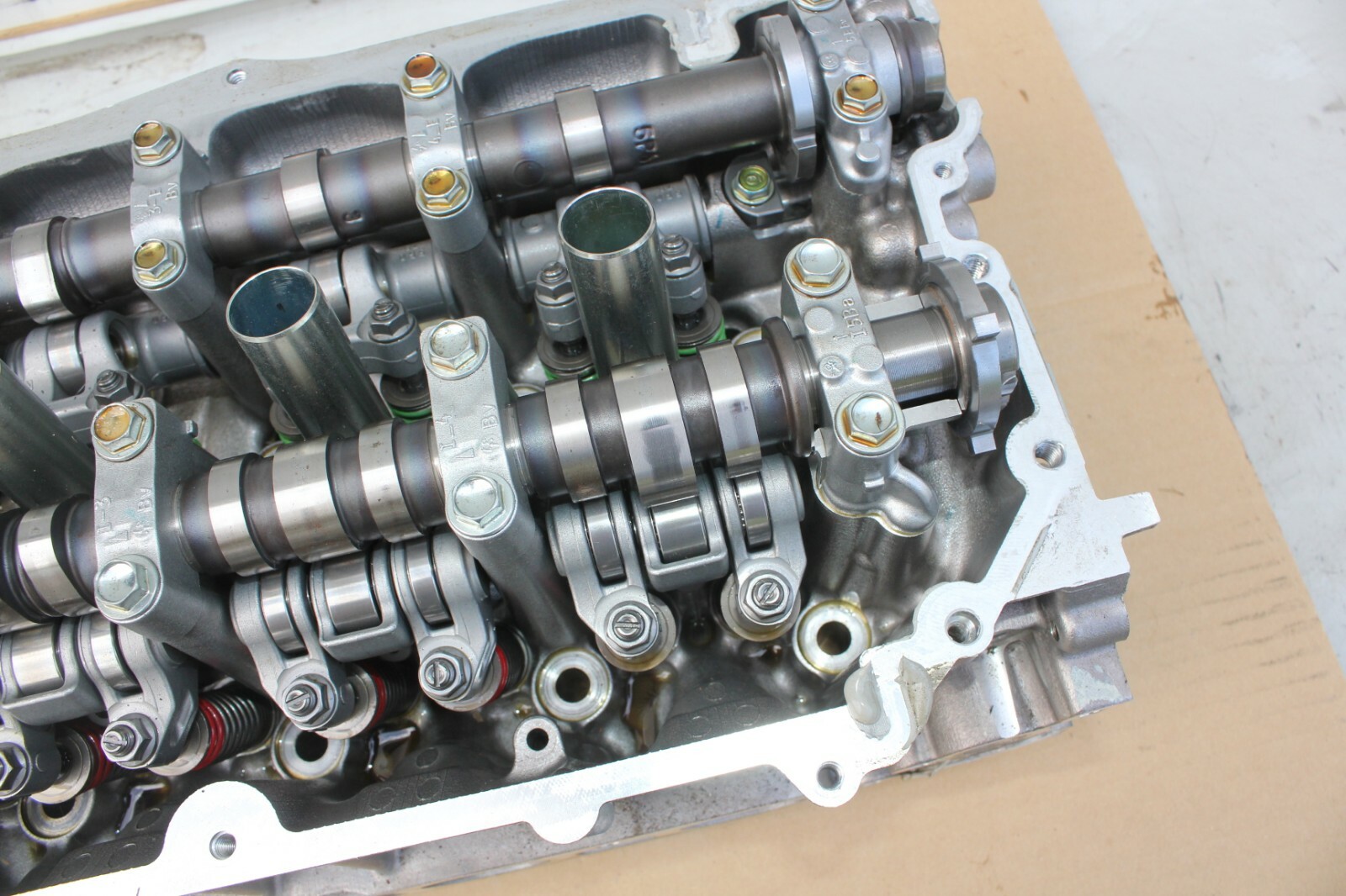

I think you are referring to Post #16... You are right, that is certainly suspect. @SR2K states that it comes from Honda's iN network, but I believe you are right that the Clarity has no hydraulic lifters so I wouldn't trust it. As further evidence of this, I found a Clarity cylinder head for sale on eBay and it clearly shows all manual adjustments. Have a look:
So, I agree, that the document in Post #16 is unreliable. Beyond that, I can't vouch for the specific numbers shown in the 'alldatadiy' document. But, even though the numbers in the 'bad' document are indeed different, they are pretty close and actually overlap. The 1st document shows 0.18 - 0.22 mm for intake and the 'alldatadiy' shows 0.21 - 0.25 mm. If it were me, I would just go by the 'alldatadiy' and nominally set the intake to 0.009" and the the exhaust in the 0.010" to 0.011" range.

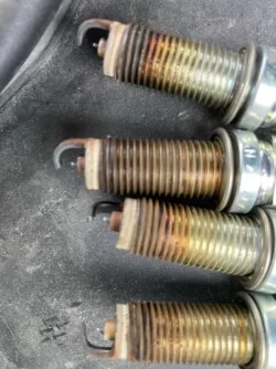

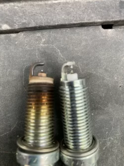

I have a little over 220,000 miles on the car (150,000 HV?), and decided to change the spark plugs.
I was getting misfires in cylinders 1 and 3 when RPM was over 4,000.
I had purchased plugs from Rock Auto about a year ago, and never put them in. I could not find those plugs, so I bought new ones from a local Honda dealer.

The old plugs were definitely due for replacement by the looks of them. I presume the new plugs 'fixed' the misfires?

I have only driven a couple hundred miles with the new plugs, but I did get over 4K RPM a couple times, so it seems like my problem is solved.
