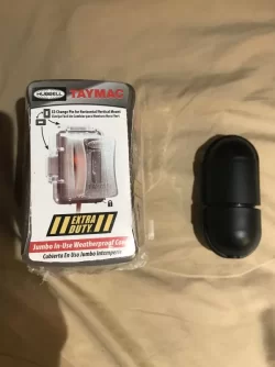

Here is an example of an outdoor outlet cover and cord plug cover:

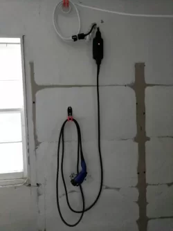

There's the setup. The power supply is mounted to the wall via the mounting holes... Will have no trouble in winter with the wet floor.1528928162448.webp
