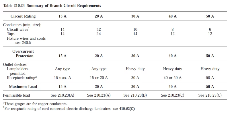

In your shoes, I might consider a compromise. You could install a 240V, 20A circuit. This only requires AWG 12 wiring (3 conductors + ground). This wire is no different than what is commonly used in the house (low cost, easy to work with). You would use a 2-pole 20A breaker for this. In the short-term, you would install a standard 120V receptacle (NEMA 5-15/20) and not use the 3rd wire. In the Clarity's future, you could trivially replace the 120V receptacle with a 240V (could use NEMA 14-50) yielding Level 2 capability. The only down-side is that you have limited your Level 2 charging to 16 amps (instead of the 30 amps that the Clarity is capable of). However, even with this limitation, your charge time improves from 12 hours to around 4 hours. You must choose a Level 2 EVSE that allows you to command the 16A limit.

Now along comes the Clarity into my household. As I mentioned the extension cord method is quite workable for now, but it's really time now to install that dedicated outlet that I have always needed in that location. But I also want to future proof for full level 2 charging, and do all of it at the same time while I have the electrician out. Thinking more about it since my original post, it really does seem that I need to install two new dedicated circuits, a 20 amp 120V NEMA 5-20 outlet and a 50 amp 240 volt NEMA 14-50. I will initially only use the 20 amp 120V outlet for charging. Of course once the 14-50 outlet is there staring at me it will be hard not to run out and get a Level 2 cable which I'm sure I will eventually do, however long my willpower holds out
although I will probably get a 16 amp EVSE which will be plenty, and since any future electric car I'm sure I will want a 40 amp EVSE to get the full power of the 50 amp outlet. Whenever I do start using the 14-50 outlet for charging I will still have the 120V 20 amp outlet available in that location for other things which is what I want.
