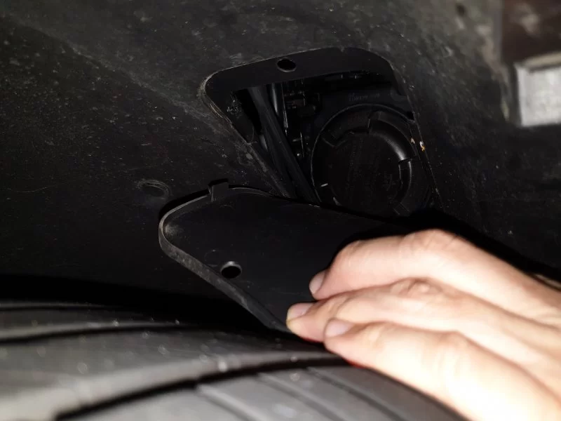

You have to read the thread. One of my earlier posts on this thread has the instructions. There is a retaining pin in the wheel well. Turn the wheel so the tire is facing out to get your hands some clearance. Remove the upper retaining pin. Just pops open. Then, from the engine compartment side, push the top of it open. The bottom is riveted, so don't break it. It is basically hinged there so the piece will sort of hang open with clearance there.

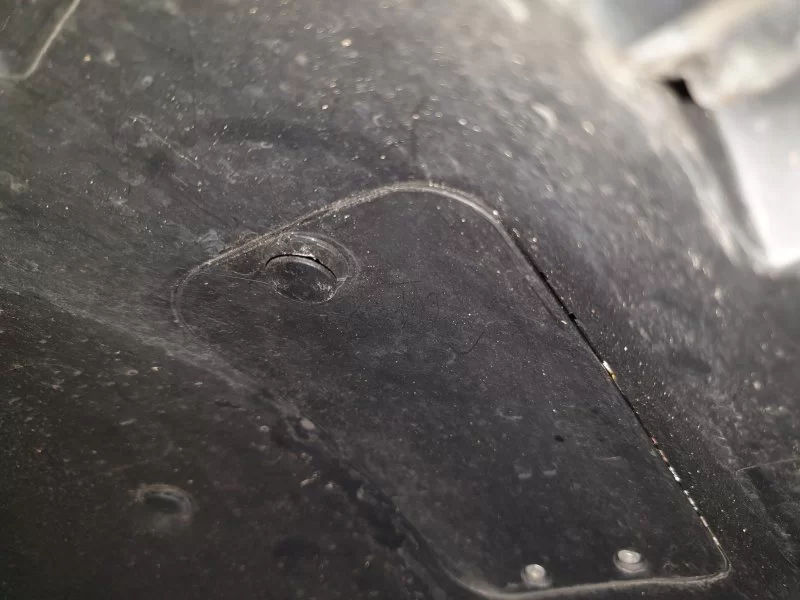

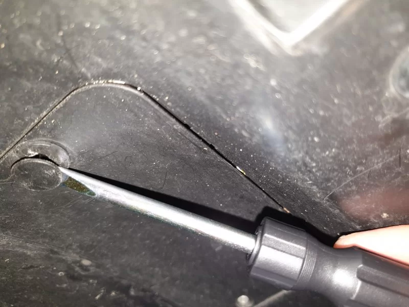

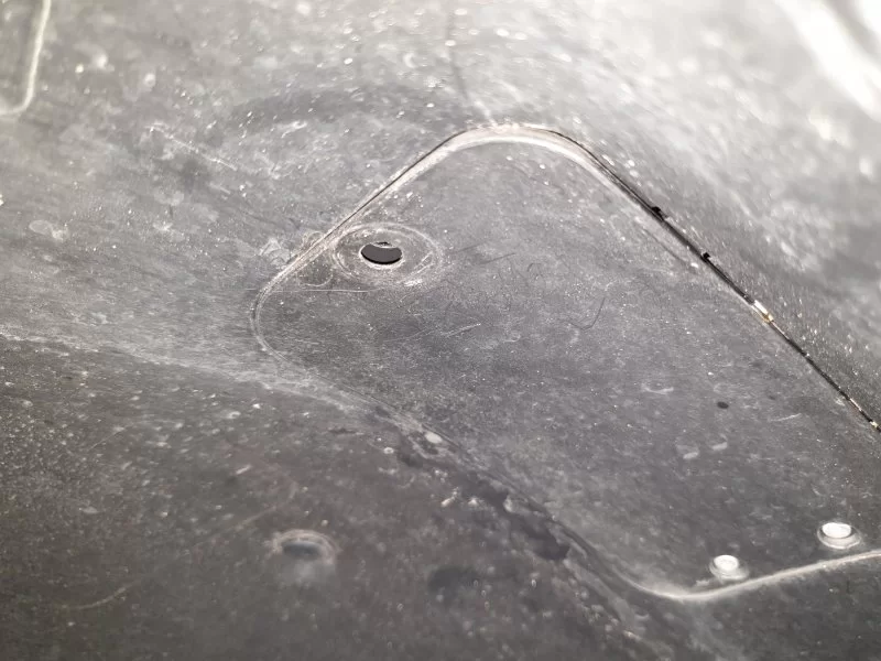

I took some photos of the access panel removal. Use a flat screwdriver and push gently into the "gap" shown on the photo. Then gently turn it to pop open the upper part of the retainer clip. The entire retainer clip can then be completely pulled out. 20200326_183710.webp 20200326_183748.webp 20200326_183828.webp 20200326_184022.webp

I took some photos of the access panel removal. Use a flat screwdriver and push gently into the "gap" shown on the photo. Then gently turn it to pop open the upper part of the retainer clip. The entire retainer clip can then be completely pulled out.View attachment 8074 View attachment 8075 View attachment 8076 View attachment 8077
