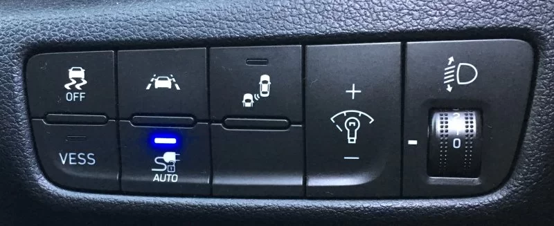

Here's a related question - do all halogen-equipped models have the height adjustment knob on the dash or is that a regional thing for mine?
Ok, it seems to be an EU requirement and this Kona was made for the Irish market. It will be handy for temporary adjustment if the LEDs don't have a sharp cut-off. If that's an issue I might have to put the halogens back in just for the govt inspection in two years as they always set the knob to zero for the test and will fail me if the cutoff is not sharp.
I'm sure you can do some sort of manual adjustment in the headlite area as well.
